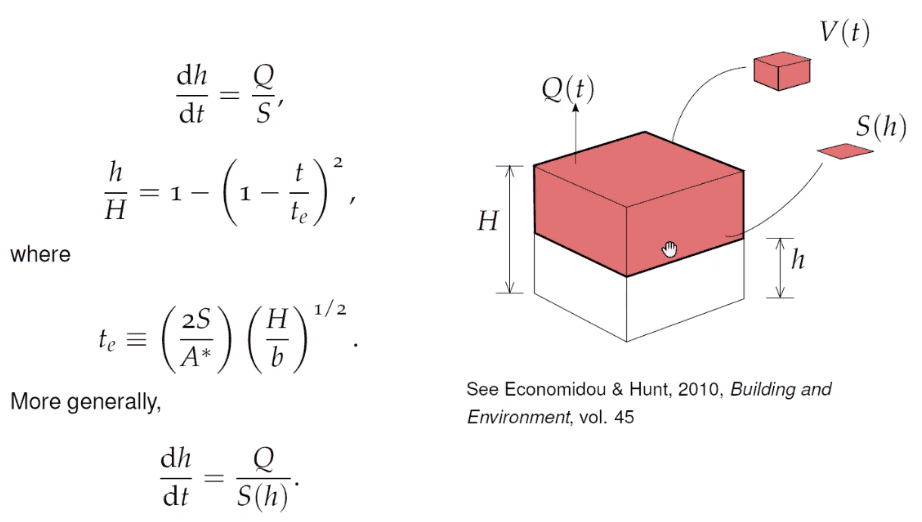

Derivation of the Emptying Time for a buoyant box to drain
In summary, the problem is to calculate the emptying time while considering volume conservation. The relevant equations are Q=A*sqrt(b(H-h(t)) and dh/dt=Q/S. The goal is to obtain h/H=1-(1-t/te)^2, with te=(2S/A*)(H/b)^1/2. The problem involves solving a 1st order ODE, but the individual is struggling with rearranging the equations. Buoyancy is also assumed in the model, with a volume flux equation of Q=A*sqrt(b(H-h(t)).
tjholi
I am having trouble deriving the expression from the initial equations. (Calculate the emptying time considering Volume conservation)
Q=A*sqrt(b(H-h(t)) And we have dh/dt =Q/S (conservation equation) and we have to obtain h/H = 1-(1-t/te)^2 with te= (2S/A*)(H/b)^1/2
Problem Statement: I am having trouble deriving the expression from the initial equations. (Calculate the emptying time considering Volume conservation)
Relevant Equations: Q=A*sqrt(b(H-h(t)) And we have dh/dt =Q/S (conservation equation) and we have to obtain h/H = 1-(1-t/te)^2 with te= (2S/A*)(H/b)^1/2
I know this is solving a 1st order ODE but I am lost at rearranging prior to solving.
This is not to be submitted, I am revising for an exam)
Thanks for your help

Can you please provide the exact word-for-word statement of this problem?
Hey : "To Calculate the emptying time consider volume conservation"
Hey, where does buoyancy come in?
Hey Chestermiller, Buoyancy is assumed as it is a model of simplified Displacement ventilation with associated volume flux Q=A*sqrt(b(H-h(t)) with A*being a constant related to the size of the openings.
