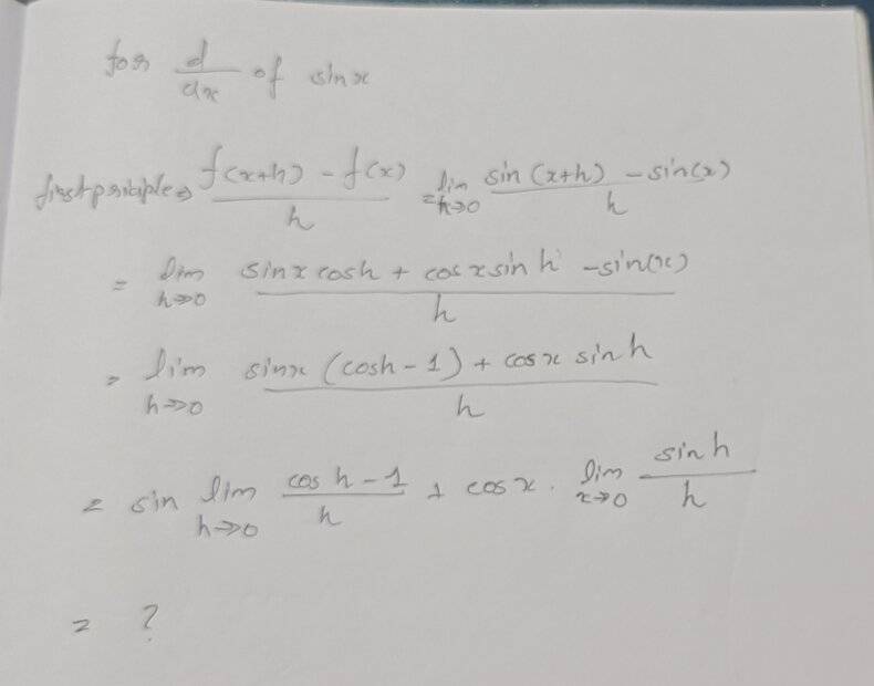

Proof of sin(x) without using any other trig derivatives unproved.
I'm trying to derive the derivatives of trigonometric equations, while I can solve others using sine's derivative, I can't derive the derivative of sin x itself.
First principle, basic algebra and basic trig
How do I do this from here without using the derivatives of sin or cos ?

It's not clear to me what you are allowed to use as "givens". But two things come to mind:
A point following a circle of radius 1 and centered at 0,0 will have it's x and y values change as functions of the sin and cos of time. That could be your starting point.
Or, if you are allowed to use the Taylor Series, then the game is over.

Using a Taylor series is begging the question: you don't how that it has one until you know that it is diefferentiable.
The idea is that [tex]
\frac{\sin(x + h)-\sin x}{h} = \frac{\sin x \cos h + \cos x \sin x}{h} = \sin x \frac{\cos(h) - 1}{h} + \cos x \frac{\sin h}{h}[/tex] and therefore [itex]\sin[/itex] is differentiable if [tex]
\begin{split}
\cos'(0) &= \lim_{h \to 0} \frac{\cos h - 1}{h}, \\
\sin'(0) &= \lim_{h \to 0} \frac{ \sin h}{h} \end{split}[/tex] both exist. You can estabish these by a geometric argument.

Mr X said:
Homework Statement: Proof of sin(x) without using any other trig derivatives unproved.
Relevant Equations: First principle, basic algebra and basic trig
The limits that a left for your last step can be found without any derivatives.

DaveE said:
google search is a wonderful thing, sometimes better than PF.
https://www.khanacademy.org/math/ol...erivtive-rules-opt-vids/v/derivative-of-sin-x
Thank you, I understood that one.
and I have to say I cannot understand half of the replies in here, it really blew up. But well it is entertaining to read through them and many facts pointed out such as there are different definitions for the same functions of angle are interesting and kinda makes me wanna delve deeper. Tho I'll save looking up all that's here for another day after I've improved a little more. So thanks everyone
