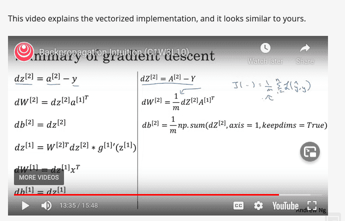

It might be just because you're using a vectorized implementation, and it's not working because you've neglected a few details (for example, the ##1/m## term)?
This video explains the vectorized implementation, and it looks similar to yours.
I don't think anyone is in doubt that you can calculate such a matrix: the problem is how do you use the matrix to alter the coefficients? What use is it having ## m ## different values you need to adjust each coefficient by to make it better fit training example ## x ##? What we want is one value for each coefficient to make it a better fit on average over all the training examples.
I think @Jarvis323 nailed it in your other thread on the same subject (why start two threads?) - you have become over-focused on doing some linear algebra and lost sight of the goal. The goal is descending the cost function surface in the direction of steepest descent: we need to find the vector that points in that direction.

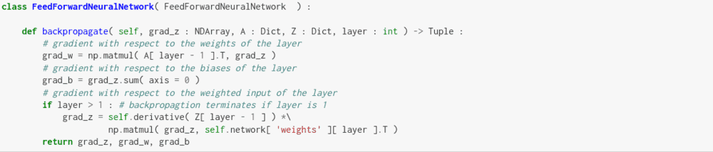

In the vectorized implementation, the main difference I see with your implentation of backpropegation and a correct vectorized implementation is this:
You compute grad_w and grad_b as:
grad_w = np.matmul( A[ layer -1 ].T, grad_z )
grad_b = np.sum( grad_z, axis=0 )
And in a correct version based on the video is:
grad_w = np.matmul( grad_z, A[ layer -1 ].T ) / batch_size
grad_b = np.sum( grad_z, axis=1, keepdims=true ) / batch_size
I don't know if the other parts of yours are a little different or not, but I think it's the same algorithm you're implementing.
Screenshot from the video with the vectorized implementation on the right and the regular implementation on the left (note you're using batches so m should be the batch size):
screenshot of your code:
By the way, I've found Andrew NG's videos to quite good and easy to understand.
When I try grad_w = np.matmul( A[ layer -1 ].T, grad_z ) , I get an error saying the dimensions are not compatible. A[ layer -1 ] should be a row vector, and grad_z should also be a row vector, but the number of elements differ, because A[ layer -1 ] is from layer - 1 and grad_z is from the layer in front of it. You can broadcast them together, but I run into problems with the dimensions later on after doing that.
You might have rows and columns swapped compared to Andrew NG's version?
