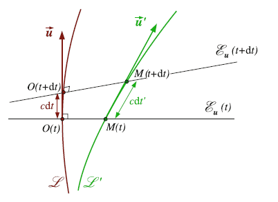

Assume a general reference frame (Observer O) along a worldline L and 4-velocity u (not necessarily inertial) and a particle P along a worldline L' and with 4-velocity u' (again not necessarily inertial). Let us assume that at instant t (=O's proper time) the observer is at "spacetime event" O(t) and the particle is (as perceived by O) at "spacetime event" M(t). Let dt be the proper time elapsed according to O and Ot(t) --> O(t+dt) and Mt) --> M(t+dt). Let now dt' be the proper time elapsed according to the particle. The Lorentz factor Γ is then defined by dt=Γdt'.
Using the fact that the vector u(t+dt) and the vector OM(t+dt) are orthogonal it can be simply shown that
Γ = (u. u')/(1+(a.OM)),
where (*.*) is the inner product w.r.t. the metric g, a is the 4-acceleration of the Observer and OM is the vector connecting O(t) and M(t).
Note that this shows that the Lorentz factor in general is not-symmetrical (unless a=0 or OM=0).
