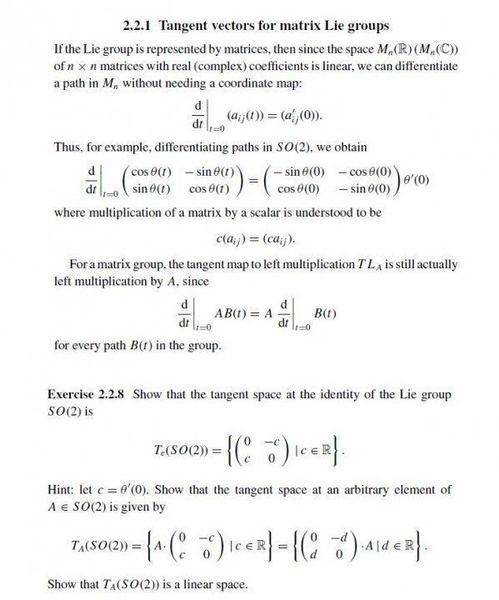

Hello,
Given a Lie group G and a smooth path γ:[-ε,ε]→G centered at g∈G (i.e., γ(0)=g), and assuming I have a chart Φ:G→U⊂ℝn, how do I define the derivative [itex]\frac{d\gamma}{dt}\mid_{t=0}[/itex] ?
I already know that many books define the derivative of matrix Lie groups in terms of an "infinitesimal change" between matrices, but I still have troubles accepting that definition because such an infinitesimal change involves the calculation of a difference between matrices, while it is assumed that the only binary operation we can perform between elements of a matrix Lie group is matrix multiplication.
The answer I am looking for should be valid for general Lie groups and it should be general enough to contain the definition of derivative of matrix Lie groups as a special case.

No, I haven't. Can you please provide the link of the thread where my question is answered?
By the way, in one of my attempts to find an answer by myself I actually obtained what I believe to be the same formula that you wrote. However, when I applied it to the specific case of G=SO(2) to calculate the derivative at the identity, I obtain something like this: [tex]
\begin{bmatrix}
\cos\theta'(0) & -\sin\theta'(0)\\
\sin\theta'(0) & \cos\theta'(0)\\
\end{bmatrix}
[/tex]
where θ(t) is a function such that θ(0)=0.
This looks wrong to me, or perhaps I don't know how to interpret it.

Hi! Thanks for your help.
I went through the steps of your calculations and it seems to me that our results agree. There is just one discrepancy between our calculations: I defined the chart [itex]\Phi: M_\theta \rightarrow \mathbb{R}[/itex] in the following way: [tex]
\begin{matrix}
\Phi\left(\begin{bmatrix}
\cos\theta & -\sin\theta\\
\sin\theta & \cos\theta
\end{bmatrix}\right) = \theta
\end{matrix}
[/tex]
In fact, I don't understand why you mapped the domain of the chart onto 2x2 antisymmetric matrices, but I would guess the results should be anyway independent of the choice of chart, am I right?
In order to obtain the resulting formula that I reported in my previous post it is sufficient to consider an arbitrary path [itex]\gamma(t)=M_{f(t)}[/itex]. Note that in your two examples you have respectively set [itex]f(t)=t\theta[/itex] and [itex]f(t)=t^2\theta[/itex]. In general, you should obtain: [tex]
\Phi^{-1} \left( \frac{d}{dt}\Phi(\gamma)\mid_{t=0}\right) = \begin{bmatrix}
\cos f'(0) & -\sin f'(0)\\
\sin f'(0) & \cos f'(0)
\end{bmatrix}
[/tex]
The problem is that our results seem to agree with each other but they seem to disagree with what I see in the book I am reading (see attachment). The author seems to differentiate paths in SO(2) in a way that looks incorrect to me (see 2nd formula). (S)he also seems to arrive at the conclusion that the tangent space at the identity is given by the space of 2x2 antisymmetric matrices, which does not seem to follow from our result.
Could you please clarify these points?

Regarding the issue I raised in my last post, I think I almost figured out what was going on.
Apparently both methods of calculating the tangent space of SO(2) are correct (the approach fresh_42 documented which used local charts, and the one explained in that book that I mentioned, that used only matrices).
From my understanding, the difference is just that in fresh_42's approach, one calculates the tangent space of SO(2) without making any reference to a parent space in which SO(2) is "contained". Instead, the "matrix approach" seems to tacitly assume that SO(2) is embedded in GL(2,ℝ). In such a scenario we can trivially put a global chart on the entire space defined in the following way:

I think we agree that one can certainly find tangent spaces without referring to a larger group. What I would like to know is whether it is always possible to do it by using matrix derivatives or not. In my opinion if you want to calculate tangent spaces of SO(2) using matrix derivatives you need to work on a larger group, like GL(2,ℝ).
For example, let's consider 2x2 matrices as elements of SO(2). And let's consider a smooth path M(t) on SO(2). Can you explicitly define a (local) chart φ on SO(2) such that:
[tex] \Phi^{-1}\left( \frac{\text{d}}{\text{d}x} \mid_{t=0} \Phi \circ M\right) = \frac{\text{d}M}{\text{d}x}\mid_{t=0} [/tex] ?
