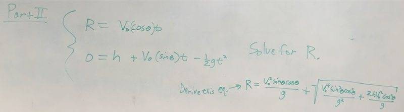

1. The problem statement, all variables, and given/known data

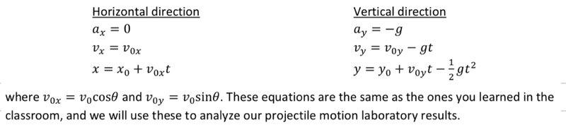

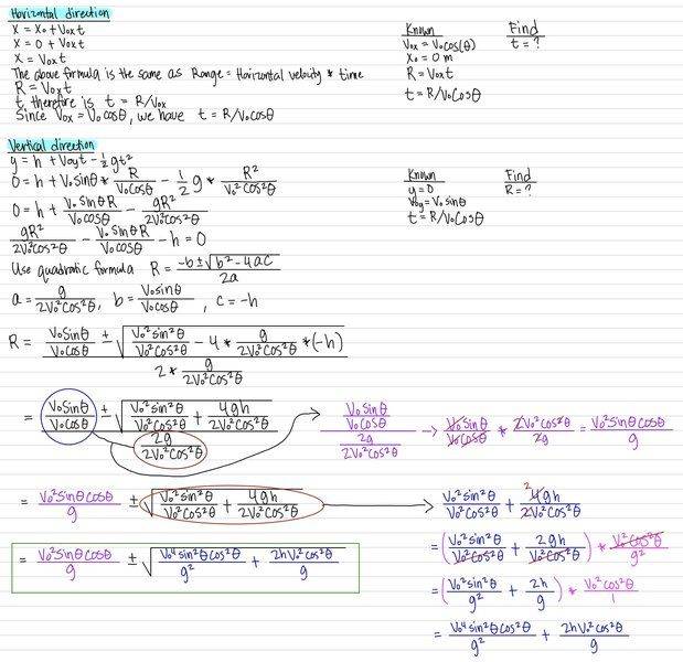

So basically I took vertical direction formula and I solved for "t". I then took the horizontal direction formula and solved for "x" or we can also call x the "Range" since that's what the problem is asking for. Is this right?
Correct. Good job!

Hey thanks, but my professor got this. The equation that I got is the same as the expression on the left side of the addition sign, and then he's adding an equation inside a square root. Why is that?
I haven't looked at your professors solution but I think yours is wrong.
If the launch angle is zero then sin(θ) = 0 and the range will always be zero unless it's fired from some initial height y0. Yet you state y0=0.
The problem statement mentions "h" which I think meant to be the initial launch height eg it's fired from the top of a hill of height h.
As @CWatters noted, you solved the problem for firing the projectile with a nonzero angle over level ground, so the projectile returns to the same height as it was fired from. But it looks like you were meant to solve a different problem where the projectile is fired horizontally (##\theta = 0##) off a cliff of height h. I apologize for not catching that earlier.

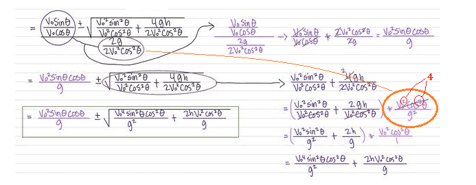

I finally solved it, but I have a question. When I used the quadratic formula, why did I have to multiply the inside of the square root by (v^2cos^2(θ))/g^2 and again by (v^2cos^2(θ))/1 ?? The part where I do this is in pink ink.
When you bring something into the square root, you have to square it. The something here is ##\frac{v_0^2 \cos ^ 2\theta}{g}##. So, after bringing it into the square root, the ##v_0## and ##\cos{\theta}## are raised to the 4th power.
