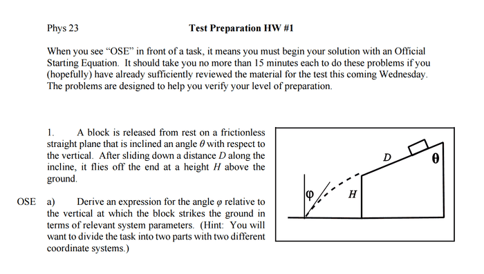

I'm really lost on this one.
I'm really not sure how to get started on this. I started it out as a force problem and solved for ax = g*cos(theta). I then integrated that (treating it like a constant) from zero to D to find my initial velocity at the time the block reaches the edge of the cliff. I then used the position function:
y=y0+v0yt+1/2ayt^2
to determine the time it takes to hit the ground, but I don't understand how any of this will help me find the angle φ. I'm really just lost. Can somebody please work this problem so I won't be so confused?

What "vertical" distance does the block travel while sliding down the incline?
What does conservation of energy tell you about the speed of the block as it leaves the incline?
The vertical distance it travels is D*Cos(theta). The horizontal distance it travels is D*Sin(theta).
