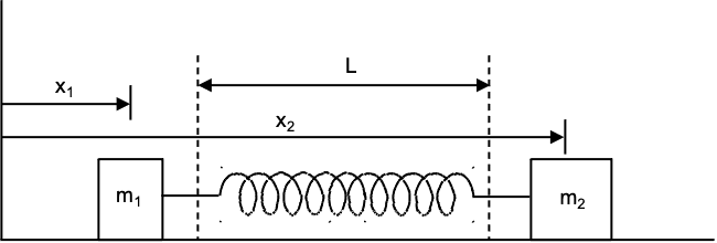

Two masses m1 and m2 on the x axis are connected by a spring. The spring has stiffness s, length l and extension x. m2 is at position x2 and m1 at position x1. The equations of the motion are
m1d^2x1/dt^2 = sx and m2d^2x2/dt^2 = -sx
Combine these to show that the angular frequency is w = sqrt(s/M)
Where M = m1m2/ m1 + m2 (the reduced mass)

tried writing the x position as
x = Acos(wt) (ignoring the phase)
so that d2x / dt2 = -w2x
Substituting that into the individual motion equations would get the required result for the individual masses, but I am not sure how to combine the equations to get the reduced mass

Here is a figure to help you out with setting the equations. When the spring is unstretched, the masses are at the dotted lines, i.e. ##x_1-x_1=L##.

so_gr_lo said:
I used between x = x2-x1
This is not correct.
##x## represents the amount of stretch of the spring from its unstretched length ##l##. So, if ##x = 0##, then ##x_2 - x_1## = ##l##. Your equation doesn't satisfy this condition.
So x = x2-x1-l
so_gr_lo said:
So x = x2-x1-l
Yes, that's the correct relation.
Okay, but if I substitute that into the equations I get
m1(d2x2/dt2) - d2x1/dt2) = sx
and similar for m2, how does this help with combining them?
This is not correct. You already had the correct equations of motion for ##m_1## and ##m_2## in the "Relevant Equations" section of your first post.
You also have ##\ddot x = \ddot x_2 - \ddot x_1##. Use the equations of motion to express the right side in terms of ##s##, ##x##, and the masses.
