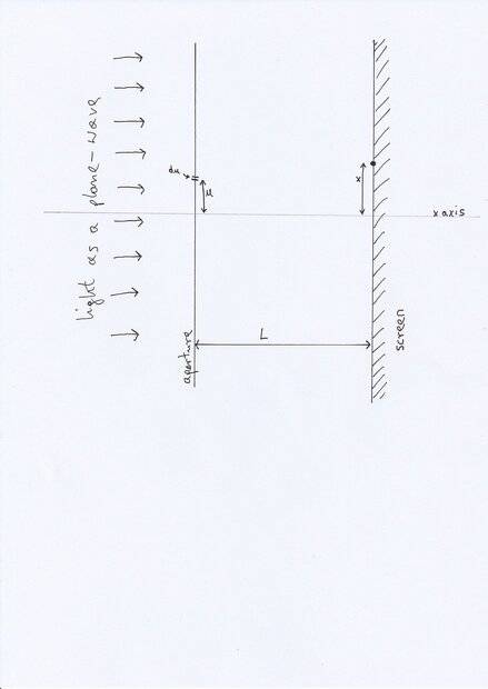

I've been trying to derive a formula for diffraction pattern formed by casting a plane-wave through a generic 1D aperture onto a screen distanced ##L## from the aperture. The aperture is described by an opacity function ##f:\mathbb{R} \rightarrow [0,1]## so it can be a single slit, multiple slits, shaded glass with varying opacity. By the Huygens-Fresnel principle every point on that aperture is a spherical wave and we weigh them by infinitesimal ##du## so that it can be integrated.
Let ##u## be the position on the aperture relative to some chosen axis which also goes through the screen. Let the position on the screen relative to that axis be ##x##. The opacity function is a function of ##u##, i.e. ##f=f(u)##.
The wave that goes through point ##u## on reaching the screen has amplitude
$$A f(u) \cos\left(\frac{2\pi}{\lambda}\sqrt{(x-u)^2+L^2 }\right) du,$$
and the resulting diffraction will be
$$A \int_{\mathbb{R}} f(u) \cos\left(\frac{2\pi}{\lambda}\sqrt{(x-u)^2+L^2 }\right) du.$$
It's a function of ##x## and we would square it to get intensity. I'm not sure how to proceed or what I did wrong. This approach is the only approach I am interested in. I'm trying to obtaining something similar to Fourier transform. What's missing here?

I care but I am not so good in this type of problems that's why I hesitate to type my thoughts. However I liked the generalization of this problem (function ##f(u)##) and the way you use Huygens-Fresnel principle to integrate over all possible sources. The only problem I see with that integral expression is that :
  • you have to divide by the total length of the aperture, pretty much the same way you divide by ##b-a## when you calculate the average value of a function ##f(x)## over the interval ##[a,b]##, $$\mu=\frac{1}{b-a}\int_a^b f(x)dx$$
  • your integral though it doesn't seem very complicated, yet it doesn't seem to have a closed analytical antiderivative, at least wolfram alpha can't find it (I tried it with ##f(u)=1## the constant function).
Have you try to do numerical integration using some math software (mathematica, MATLAB e.t.c) for the case f(u) is the function that corresponds to a single slit to see what diffraction pattern you get?
What do you mean when you say you want to get something similar to Fourier transform? Fourier transform of ##f(u)##?
