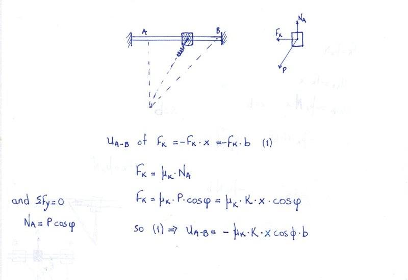

14.6 The coefficient of kinetic friction between the slider and the rod is μ, and the
free length of the spring is ##L_0 = b##. Derive the expression for the work done by
the friction force on the slider as it moves from A to B. Neglect the weight of the slider.
I[/B] am going the right direction with my solution?
I don't see to be getting the ##-0.1186μkb^2## solution.

##\mu## stands for the ratio of the friction force and some normal force. What's that normal force as a function of position ?

It is preferred that you type in your algebra. This makes it easier to comment on specific lines. Or you could number the equations.
Your FBD omits the force dragging the slider from A to B. You should take acceleration to be negligible. This invalidates your force balance equation for the x direction.

For the x direction:
##ΣFx=0 => F-F_k=0 => F=F_k## (1)
For the y direction:
##ΣFy=0 => N_A-Pcosφ=0 => N_A=Pcos(φ)## (2)
haruspex said:
The NA=P cos(φ) equation is the useful one, but you need to find P as a function of φ and integrate
How do I do that? I am a bit confused...

How would you calculate ##P## at point B ?
It's the tension in a spring. What determines the value of that?
BvU said:
How would you calculate PPP at point B ?
P at point B be should be ## -kx## where x is the elongation of the spring.
##x = L_B-L_0 = \sqrt {b^2+b^2} - b = 0.414b##
So P = -0.414kb
Am I correct? (it is the second problem with springs ever i am trying to solve )

I think the problem is a lot more complicated than that. First, you need an expression for the length of the spring as a function of the distance from A to B.
So to do that I split the distance between A and B to 3 sections. from 0 to 1/3 of b, from 1/3b to 2/3b, and from 2/3b to b.
At 1/3b ##sinφ = \frac {1b/3} {l} => sinφ = \frac {1b/3} {1.054b} = 0.316## (where ##l = b + L_{1/3b} - L_0##)
At 2/3b ##sinφ = 0.55##
At 3/3b ##sinφ = 0.707## that verifies that when collar is at position B the angle φ is 45 degrees.
So from above we can say that ##l = L_{AB} = \sqrt {b^2+(xb)^2}## where x is between 0 and 1
Well, I'd say just use good old Pythagoras:
##L = \sqrt{x^2 + b^2}##, where ##0 \le x \le b##
Now you need to analyse the forces at each point ##x## between ##A## and ##B##.

Remember the last line in #4: You need ##P## as a function of ##\phi##. I think you do fine for ##\phi## at specific values, but you need a function for all ##\phi## in ##[0,\pi/4]##

in y-axis ##N_A = P_y => N_A = Pcos(φ)##
in x-axis ##-F_k - P_x < F## (Is this correct?)
BvU said:
Remember the last line in #4: You need P as a function of ϕ. I think you do fine for ϕ at specific values, but you need a function for all ϕ in [0,π/4]
##P=Pcos(φ) ## (Is this correct?)

##\ P_y = P \cos\phi## is right. Both factors change during the trip. So fill in something for ##P##: a function of ##\phi##.
BvU said:
Py=Pcosϕ is right. Both factors change during the trip. So fill in something for P: a function of ϕ
The only thing i understand is that ##P = -kl##
I can see that as the angle increases so does P. So P∝φ
should it be P related to ##1/cos(φ) ? If angle is 0deg the 1/cos(φ) is 1; Then as angle increases so does 1/cos(φ);
Write it out in full so you have something that you can integrate from ##\phi=0## to ##\phi = \pi/2##...
To help you: ##k## is given. Now you need ##l(\phi)## -- you did it already, see above

Post #10, but you would do better to use PeroK's simplification in post #11. It will be more convenient to have x as the distance along the bar from A, so x ranges from 0 to b.
