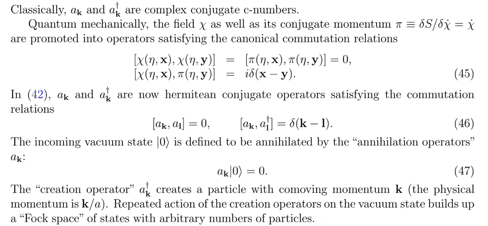

Given the commutation relations
\begin{equation*}
[\chi(\eta, \vec x), \chi(\eta, \vec y)] = [\dot \chi(\eta, \vec x), \dot \chi(\eta, \vec y)] = 0,
\end{equation*}
\begin{equation*}
[\chi(\eta, \vec x), \dot \chi(\eta, \vec y)] = i \delta(\vec x - \vec y)
\end{equation*}

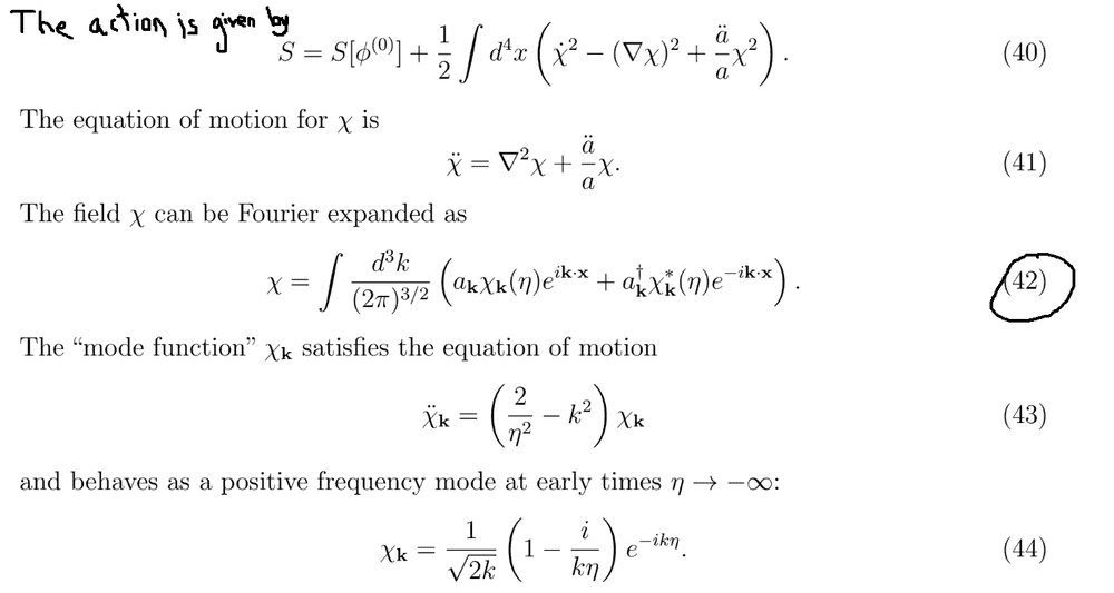

Where ##\eta## stands for conformal time and ##\chi## is given by
\begin{equation}
\chi = \int \frac{d^3 k}{(2 \pi)^{3/2}} \left( a_{\vec k} \chi_{\vec k} e^{i \vec k \cdot \vec x} + a^{\dagger}_{\vec k}\chi^*_{\vec k} e^{-i \vec k \cdot \vec x} \right) \tag{1}
\end{equation}
Show that
\begin{equation*}
[a_{\vec k}, a_{\vec k'}]=0, \quad [a_{\vec k}, a_{\vec k'}^{\dagger}]= \delta^{(3)}(\vec k -\vec k')
\end{equation*}

I would say we first need to take the inverse Fourier transform of ##\chi## and associated quantities i.e.
\begin{equation*}
\chi_{\vec k} = \int d^3 \vec x \left( a_{\vec k} \chi e^{-i \vec k \cdot \vec x} + a^{\dagger}_{\vec k}\chi^* e^{i \vec k \cdot \vec x} \right) \tag{2}
\end{equation*}
\begin{equation}
\dot \chi_{\vec k} = \int d^3 \vec x \left( a_{\vec k} \dot \chi e^{-i \vec k \cdot \vec x} + a^{\dagger}_{\vec k}\dot \chi^* e^{i \vec k \cdot \vec x} \right) \tag{3}
\end{equation}
\begin{equation}
\chi_{\vec k}^* = \int d^3 \vec x \left( a_{\vec k}^{\dagger} \chi^* e^{i \vec k \cdot \vec x} + a_{\vec k} \chi e^{-i \vec k \cdot \vec x} \right) \tag{4}
\end{equation}
\begin{equation}
\dot \chi_{\vec k}^* = \int d^3 \vec x \left( a_{\vec k}^{\dagger} \dot \chi^* e^{i \vec k \cdot \vec x} + a_{\vec k} \dot \chi e^{-i \vec k \cdot \vec x} \right) \tag{5}
\end{equation}
At this point I should perform a linear combination of ##(2), (3), (4), (5)##, obtaining ##a_{\vec k}## in terms of ##\chi## and ##\dot \chi## (as well as ##a_{\vec k}^{\dagger}## in terms of ##\chi## and ##\dot \chi##).
However, I do not see such linear combination. Might you please shed some light? I should be able to continue once I get such expressions.

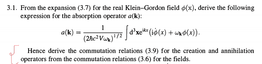

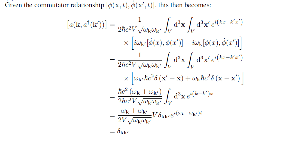

PS: I've been studying a really similar problem (M&S chapter 1) and they indeed make the student to first derive and expression for ##a##. I am trying to solve this problem in a completely analogous way and any help would be highly appreciated

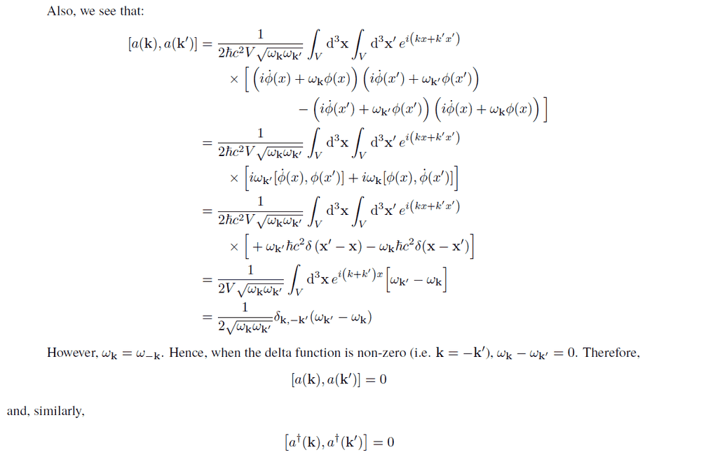

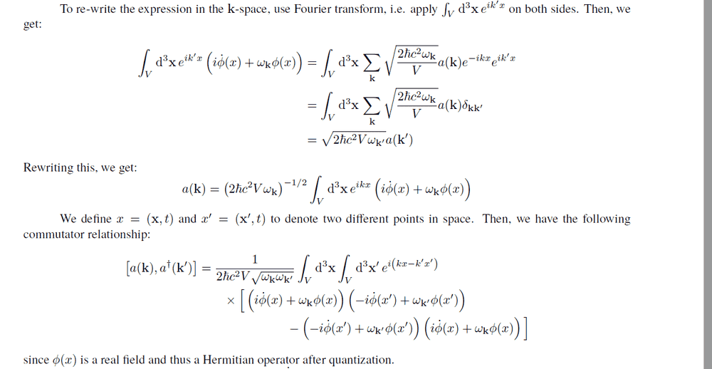

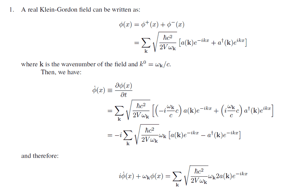

To prove the original statement of this thread I am convinced it has to be possible to follow essentially the same steps one needs to solve M&S 3.1. These are
1) Find the explicit expression of ##a## in terms of ##\chi## and ##\dot \chi## (for us it is a bit harder because we are not given the explicit expression of ##a## in terms of ##\chi## and ##\dot \chi##).
2) Evaluate the ##a## commutators with the expression obtained at 1).
So the issue is 1). Studying how it is done for 3.1. one sees that, when taking the time derivative of the KG field, as the Fourier-expansion exponentials of the KG field depend on time, we can essentially take the linear combination ##\phi + \dot \phi## and we get the desired expression. However, in our particular problem this "trick" does not work because, as you both noticed, the Fourier-expansion exponentials of the ##\chi## do not depend on time... So we need another "trick".

We start off by taking the Fourier transform of the operators ##\chi## and ##\dot \chi##
\begin{equation*}
\tilde \chi = \int \frac{d^3 \vec x}{(2\pi)^{3/2}} \chi e^{-i \vec k \cdot \vec x}
\end{equation*}
\begin{equation*}
\tilde{\dot \chi} = \int \frac{d^3 \vec x}{(2\pi)^{3/2}} \dot \chi e^{-i \vec k \cdot \vec x}
\end{equation*}
Plugging them into the Fourier expansion (1) in the OP we get
\begin{align*}
\tilde \chi &= \int \frac{d^3 \vec x}{(2\pi)^{3/2}} \int \frac{d^3 \vec k'}{(2 \pi)^{3/2}} \left( a_{\vec k'} \chi_{\vec k'} e^{i \vec k' \cdot \vec x} + a^{\dagger}_{\vec k'}\chi^*_{\vec k'} e^{-i \vec k' \cdot \vec x} \right) e^{-i \vec k \cdot \vec x} \nonumber \\
&= \int \frac{d^3 \vec x d^3 \vec k'}{(2\pi)^3} \left(a_{\vec k'} \chi_{\vec k'} e^{i (\vec k' - \vec k ) \cdot \vec x} + a_{\vec k'}^{\dagger} \chi_{\vec k'}^* e^{-i (\vec k' + \vec k ) \cdot \vec x} \right) \nonumber \\
&= \int \frac{d^3 \vec k'}{(2\pi)^3}\left(a_{\vec k'} \chi_{\vec k'} \delta^{(3)}(\vec k' -\vec k) + a_{\vec k'}^{\dagger} \chi_{\vec k'}^* \delta^{(3)}(\vec k' +\vec k) \right) \nonumber \\
&= a_{\vec k} \chi_{\vec k} + a_{-\vec k}^{\dagger} \chi_{-\vec k}^*
\end{align*}
Similarly we get
\begin{equation*}
\tilde{\dot \chi} = a_{\vec k} \dot \chi_{\vec k} + a_{-\vec k}^{\dagger} \dot \chi_{-\vec k}^*
\end{equation*}
At this point we notice we have a ##2 \times 2## system of equations and all we have to do is solve it for ##a_{\vec k}## and ##a_{\vec k}^{\dagger}##. First we notice that ##\chi_{\vec k} = \chi_{-\vec k}## (this is because the equation of motion for ##\chi_{\vec k}## (equation (43) in #7) depends on the square of momentum ##k##). So our system of equations can be equivalently written to be
