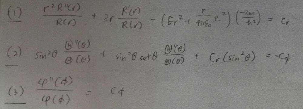

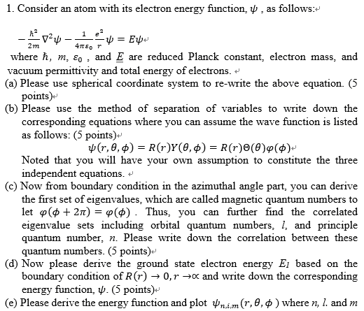

Derive the ground state electron energy ##E_1## based on the boundary condition of R(r) -> 0, r -> ∞ and write down the corresponding energy function, Psi. (5 points)
Schrodinger's Equation (below)
This is the equation given.

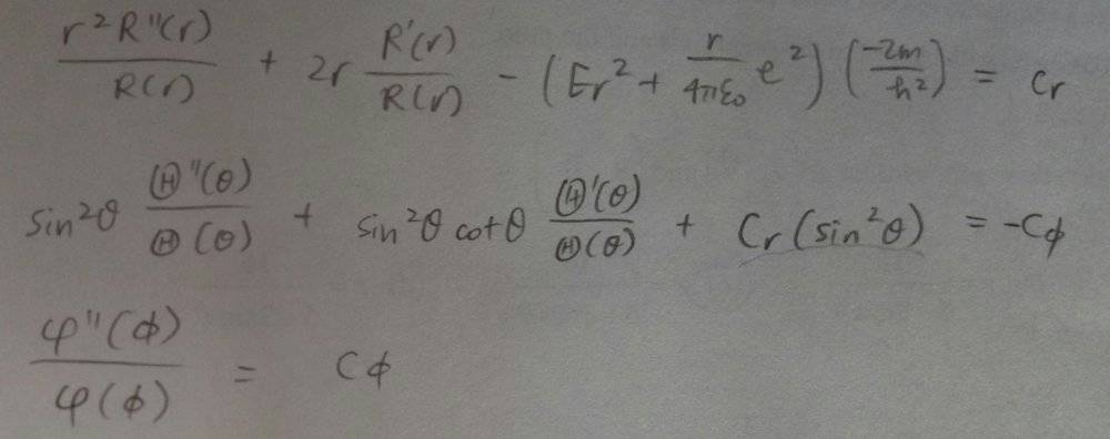

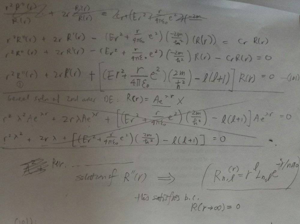

I attempted to use Radial Equation, obtained from separating variables, to solve for ##E_1##.

Here's the problem. the equation was stated in class to be Schrodinger's Equation.
Last problem should say: n, l, and m are arbitrary constants.
We are now in part (d) of your exercise. I can hardly read, let alone quote from your jpg.
What constraints are there on ##l##, and what does that mean when in the ground state ##n=0## ?
