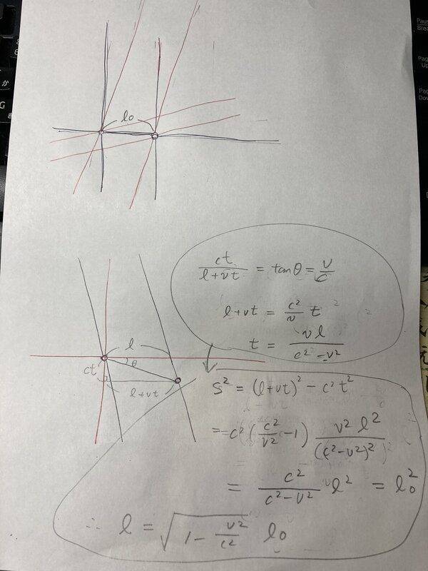

Derive time dilation and length contraction using invariance of spacetime interval.
##ds^2 = dx^2+dy^2+dz^2 - c^2 dt^2##
Deriving time dilation was easy:
Imagine two events in frame O' at the same location.
##ds^2 = -c^2 dt'^2##
The same viewed in O frame is:
##ds^2 = dx^2+dy^2 + dz^2 - c^2 dt^2##
##\Rightarrow dx^2+dy^2 + dz^2 - c^2 dt^2 = -c^2 dt'^2##
##\Rightarrow (\frac{dx}{dt})^2+(\frac{dy}{dt})^2+ (\frac{dz}{dt})^2 - c^2 = -c^2(\frac{dt'}{dt})^2##
But since these events are at the same location in O', the dx, dy, dz is hence the amount by which O' moves in O in time dt.
Therefore,
##v^2 -c^2 = -c^2 (\frac{dt'}{dt})^2##
##\Rightarrow (\frac{dt'}{dt})^2 = 1-\frac{v^2}{c^2}##
##\Rightarrow (\frac{dt'}{dt}) = \sqrt{1-\frac{v^2}{c^2}}##
##\Rightarrow dt = \gamma dt'##
But for length contraction
I choose two events in O which are simultaneous. So dt=0
##ds^2 = dx^2+dy^2 + dz^2 = dx'^2 + dy'^2 + dz'^2 - c^2 dt'^2##
Here I can not equate any of these with the amount by which O' moves in O.
Please help.

I did it as attached.

I suggest you take an object of proper length ##L## and describe the spacetime coordinates of each end in a second frame where the object is moving with constant velocity ##\vec v##.
PS you can also use this idea to give a much simpler derivation of time dilation. You start with a clock in its rest frame having the coordinates: ##(t', 0, 0, 0)## and in other frame coordinates ##(t, v_xt, v_yt, v_zt)##.
Note: if the object does not pass through the spacetime origin, then we have coordinates ##(t', x'_0, y'_0, z'_0)## and ##(t, x_0 + v_xt, y_0 + v_yt, z_0 + v_zt)## and it all works out just as well.

Wouldn't that be just plain derivation using Lorentz Transformations ?

Not if you use the invariance rather than the explicit LT.

Let me show you what I mean.
We have two events described in two different reference frames by the coordinates:
$$(t'_0, 0, 0, 0), (t'_1, 0, 0, 0)$$ and $$(t_0, x_0, y_0, z_0), (t_1, x_0 + v_xt_1, y_0 + v_yt_1, z_0 + v_zt_1)$$
Instead of using the LT and the explicit relationship between these coordinates, we can use only the invariance of the spacetime interval, to give: $$(\Delta s')^2 = (\Delta s)^2$$ $$\Rightarrow \ -c^2(\Delta t')^2 = -c^2(\Delta t)^2 + (v_x^2 + v_y^2 + v_z^2)(\Delta t)^2 = -c^2(\Delta t)^2 + v^2(\Delta t)^2 = -c^2(1 - \frac{v^2}{c^2})(\Delta t)^2$$ And we can get the time dilation formula.
