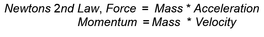

Force = Mass * Acceleration
Momentum = Mass * Velocity
Hello everyone
I was hoping someone could shed some light on the following:-
I am trying to derive the equation of Momentum from Newton's 2nd Law.
What I know is the following:-
I don't know how to get from Force = Mass * Acceleration TO Momentum = Mass * Velocity.

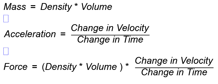

I have attempted to re-write Mass and Velocity which gets me to the following:-
But i still am struggling to derive the equation of Momentum (Mass * Velocity) from the above equations?

You also need Newton's third law.
Newton's second law says that force is the rate of change of momentum, ##F=\dfrac{dp}{dt}##. For movements with a constant acceleration, which is what you seem to be doing, it becomes ##F=\dfrac{\Delta p}{\Delta t}=\dfrac{mv_f-mv_i}{\Delta t}##.
It is postulated this way.

You know that acceleration is the time derivative of velocity, a=dv/dt.. So Newton's second law is:
F= mdv/dt. For constant mass, mdv/dt is the time derivative of (mv), called momentum, p.

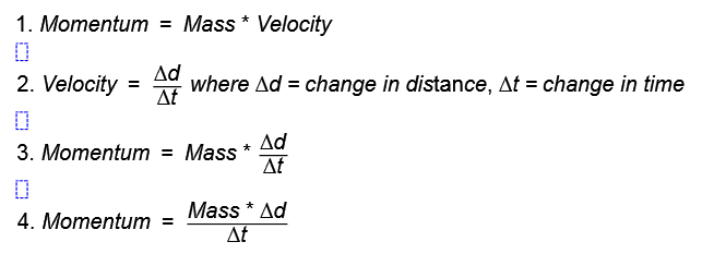

I re-wrote velocity out to get:-
But this is as far as i get.

From set 7, i have Force = Mass * derivative of velocity with respect to time.
However when i multiply Mass by dv, then dv/dt is no longer the derivative but Delta V - or have i gotton myself confused.
We speak of derivatives, so do not separate dv and dt. dv/dt is the derivative of v with respect to time, Delta v is the change of the velocity. They are different things. Also, dv/dt (derivative) is not the same as ##\Delta v/\Delta t##
You know what is the derivative of a function f(t) multiplied by a constant c : d(c f(t))/dt = c df/dt.
Here the constant is the mass, m, and the function is the velocity v(t), so
m(dv/dt) = d(mv)/dt = dp/dt .
mv=p
is called momentum.
So we can rewrite Newton's second law as F=ma=m(dv/dt)=d(mv)/dt=dp/dt
F=dp/dt :
The force is equal to the time derivative of the momentum.

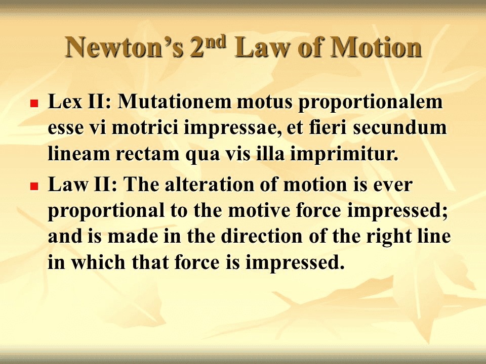

LAW II​
The alteration of motion is ever proportional to the motive force impressed; and is made in the direction of the right line in which that force is impressed.
https://jamesbrennan.org/physics/notes/Force/axioms.htm
I wonder what he meant by "alteration of motion"
Likes PeroK
That's a translation from Latin!
I know. Mutationem motus - change of motion.
Newton did not mention velocity and acceleration in his laws. He spoke about motion, and change of motion. I wonder why is it said that the original wording of the Second Law meant that "the change of momentum is equal to the force". It can be understood as "the change of velocity is proportional to the force".
