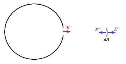

Calculate the outward electrostatic pressure acting on a spherical, isolated water droplet of net charge q, radius r.
Gauss's Law, electric fields
I assumed a uniform distribution of charge within the droplet such that ##E = \frac{q}{4\pi\epsilon_{0}r^{2}}## at the outside surface. I then said that the pressure acting at the surface would be the force on a charge element ##dq## within an area ##dA## on the surface, divided by the area. This doesn't appear to be particularly useful:
$$P = \frac{q}{4\pi\epsilon_{0}r^{2}}\frac{dq}{dA}$$
The right term is the area density ##\sigma##, yet I can't find a way to obtain this quantity (and if the area element is of zero width, it seems as if ##\sigma = 0## because it is the volume distribution which is uniform).
So how could we compute pressure?

You could do this. But when you integrate, you only want to integrate over rings that do not include any of the charge of the little patch of area ##dA## for which you are calculating the force.
The picture shows the spherical shell with the little patch of area ##dA## removed off to the side. This area would fill the hole shown in the shell. The force on ##dA## is due to the electric field ##E'## at the hole that is produced by all the charge on the shell (without the patch in place). Integrating over the rings of the shell (with the hole) would give you ##E'##. But that doesn't seem like much fun.
Instead, see if you can use superposition ideas. The little patch ##dA## can be thought of as a little disk that produces its own electric field ##E''## as shown in blue. If you replace ##dA## back in the hole, the superposition of the red and blue fields must produce the total field of a complete spherical shell of charge. This idea can be used to find ##E'## without much calculation.
Ah, so if put ##E''## as ##\frac{\sigma}{2\epsilon_{0}}##, then we must have
##\frac{\sigma}{2\epsilon_{0}} + E' = \frac{Q}{4\pi\epsilon_{0}r^{2}}## just above the surface of ##dA##?
Yes
