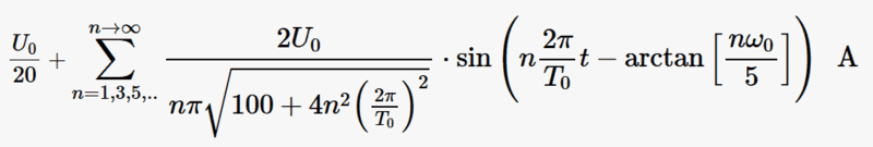

Hello.
$$ \textbf{Example: RL circuit forced upon by a unipolar square wave with half duty cycle} $$
I just derived this easy example myself using this setup:
$$ R = 10 \,\,\,\, \Omega \,\,\,\,\,\,\,\,\,\,\,\,\,\,\, L = 2 \,\, \text{H} $$
The wave here is:
$$ v(t) = \begin{cases} U_{0} & \text{$ t \in [ 0 , \frac{T_{0}}{2} ]$} \\ 0 & \text{$ t \in [\frac{T_{0}}{2}, T_{0} ] $} \\ \end{cases} $$
Periodic with ##T_{0}##. and thus the fundamental frequency is: ## \omega_{0} = \dfrac{2 \pi}{T_{0}} ##
We first derive the expression for the voltage across the inductance, using phasors:
$$ V_{L} = V_{s} \cdot \dfrac{ j \omega L }{ R + j \omega L } = V_{s} \cdot \dfrac{j 2 \omega}{10 + j 2 \omega} $$
$$ V_{L} = V_{s} \cdot \dfrac{j 2 \omega}{10 + j 2 \omega} $$
Now after deriving the Fourier transform I got:
v(t) = \dfrac{U_{0}}{2} + \displaystyle \sum_{n = 1, 3, 5, 7, 9..}^{n \to \infty} \dfrac{2 U_{0}}{n \pi} \sin(n \frac{2 \pi}{T_{0}} t)
Now finding the responses for all the harmonics, with ## n \omega_{0} ## and converting the sine in the Fourier transform to its phasor:
\dfrac{2 U_{0}}{n \pi} \sin(n \frac{2 \pi}{T_{0}} t) \rightarrow - \dfrac{2 U_{0}}{n \pi}j
Plugging this into the impedence voltage divider for the inductor and multiplying by the admittance of the inductor, to find the current, the impedence frequency expression for all harmonics becomes:
- \dfrac{2 U_{0}}{n \pi}j \cdot \dfrac{j 2 n \omega_{0} }{10 + j 2 n \omega_{0} } \cdot \dfrac{1}{j 2 n \omega_{0} } = - \dfrac{2 U_{0}}{n \pi}j \cdot \dfrac{1}{ 10 + j 2 n \omega_{0} }
We know the phasor current for the inductor at all odd number multiples of the fundamental frequency now:
I_{L (n \omega_{0})} = - \dfrac{2 U_{0}}{n \pi}j \cdot \dfrac{1}{ 10 + j 2 n \omega_{0} }
Expressing the above as a complex number with magnitude and phase:
I_{L (n \omega_{0})} = \dfrac{ 2 U_{0} }{ n \pi \sqrt{100 + 4n^{2} {\omega_{0}}^{2} } } \angle{ - \dfrac{\pi}{2} - \arctan{\Big[ \dfrac{n \omega_{0}}{5} \Big]} }
Converting this to the time domain:
i(t, n \omega_{0} ) = \dfrac{ 2 U_{0} }{ n \pi \sqrt{100 + 4n^{2} {\frac{2 \pi}{T_{0}} }^{2} } } \cdot \sin \Bigg[n \frac{2 \pi}{T_{0}} t - \arctan{\Big[ \dfrac{n \omega_{0}}{5} \Big]} \Bigg]
The Fourier series for the current is:
i(t) = \dfrac{U_{0}}{20} + \large \displaystyle \sum_{n = 1, 3, 5,.. }^{n \to \infty} \dfrac{ 2 U_{0} }{ n \pi \sqrt{100 + 4n^{2} {\left(\frac{2 \pi}{T_{0}} \right)}^{2} } } \cdot \sin \Bigg(n \frac{2 \pi}{T_{0}} t - \arctan{\Big[ \dfrac{n \omega_{0}}{5} \Big]} \Bigg) \,\,\,\,\, \text{A}
So its not that complicated.
The input waveform is expressed as a Fourier series.
The output relation with the input is found using physical laws or circuit theorems in the frequency phasor domain.
The input is expressed as a phasor, and then plugged into the relation of the frequency domain, the dependence on the harmonics is also considered.
This result is then converted back to the time domain, and expressed as another Fourier series.

AVBs2Systems said:
Hello.
The wave here is:
