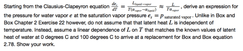

There is a picture attached showing the entire problem.
Equation 2.78 is the Clausius Clapeyron equation.
Clausius Clayperon equation.
L = L'T (since there is a linear dependence on temperature)
$$ \frac{de_s}{dT} = \frac{L}{T\alpha} $$
$$ pV = RT $$ $$ V= RT/p $$
$$ \frac{dp_s}{dT} = \frac{L}{(RT^2)/p} $$
i am not sure how to continue with this though.

Let ##L_0## be the latent heat of vaporization at 0 C and ##L_{100}## be the latent heat of vaporization at 100 C. In terms of the absolute temperature T, what is the latent heat of vaporization at absolute temperature T?

I want it algebraically in terms of ##L_0## and ##L_{100}##. And I asked for it in terms of the absolute temperature T, not the centigrade temperature.

Do you not know how to determine the equation for the straight line L vs T that passes through the points (273,##L_0##) and (373, ##L_{100}##)?

that was dumb. yes of course. the equation i get for L is $$ L = (\frac{L_{100}-L_0}{100})T $$ no y-intercept.

Incorrect. Try again.

sorry! the slope is fine right? i think i forgot the y-intercept:
$$ L = (\frac{L_{100}-L_0}{100})T + 3.73L_0 - 2.73L_{100} $$
$$L = (\frac{L_{100}-L_0}{100})T + 3.73L_0 - 2.73L_{100} $$
OK. So now you have $$\frac{d\ln{p_s}}{dT}=\frac{L}{RT^2}$$
Now all you need to do is substitute for L, and integrate from T1 to T2.

$$ \frac{dp_s}{dT} = \frac{de_s}{dT} = \frac{L}{T\alpha_v} $$ for the pressure. i will plug in for L. would that be okay?

The version with ##RT^2## was correct, and the equation I wrote was correct.

just wondering, what is the $$ \alpha_v $$ that is a constant right?

No. It’s RT/ps

oh okay. it's 1/density? which is RT/ps?

Yes, it’s the molar volume of the vapor.

and i just wanted to check but my euqation for L is correct?:
also, would I be integrating from p0 to p, p0 being 101325 pa, and T1 to T2?
because if i want to find the vaporation pressure using the new equation with the temperature of 20 deg. C, what would be my T1 and T2?
like if i wanted to:
Use the expression derived in part (a) to recalculate the saturation vapor pressure at 20 °C.
