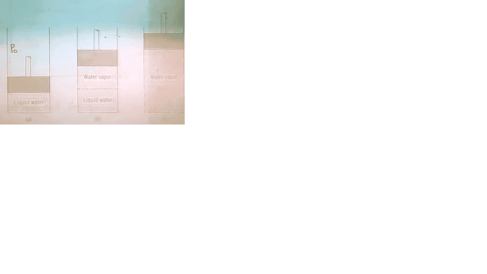

I am trying to understand the trends in the Temperature vs specific volume plot for water at constant and different pressures
I set up an experiment where I put a fixed quantity of water in a cylinder fitted with a movable piston. I slowly add heat to the system, as expected both the temperature and the volume will increase but the volume will not increase significantly (steep line), until some point where some gas bubbles begin to form, Volume increases most shallow (Temperature=constant) if I plot a graph of Temperature vs Volume. Heating beyond the point(last drop of liquid)results in a less steep curve in comparison to heating liquid water at the point where the first bubble vapor forms I add equal amounts of heat to a vapor and a liquid of the same pure substance keeping the pressure=constant the change in the gaseous state will be higher, vapor molecules have more kinetic energy thus expand at a higher rate. But repeating the same experiment at different pressures at the same initial temperature as the one conducted previously. In one case the pressure above the piston is higher than atmospheric pressure then the volume at the initial state is slightly lower. Qualitatively the same thing will happen but does vaporization occcur at a higher temperature and higher specific volume because the pressure the vapor molecules push against is higher so they must have enough K.E to do and once these molecules acquire such K.E they must have a higher velocity than at the saturation temperature for the experiment conducted previously? If I do a force balance on the piston how is the pressure =constant although more vapor molecules are produced and thus pressure must increase?

Your description also gives me a lot of doubt about the experimental methods. For example, how do you know you add "equal amounts of heat"? Is there air, or steam in the piston, or strictly liguid? Some graphics to explain your experimental setup would be helpful.
I don't understand what you are asking. I don't see what you are so puzzled about with regard to this experiment. You refer to a force balance on the piston. Maybe you can elaborate on your doubt?

My first doubt is whether the curve joining the point (saturated vapor)and the points in the superheated region is less steep than the curve joining the points in the compressed liquid region and the point(saturated liquid). Does the greater kinetic energy of vapor to expand explain why this is the case?My second doubt If we carry out the experiment at a higher external pressure starting at the same initial temperature and slowly add heat.Qualitatively the curves will look similar but will the curves be less/more steep than the curves generated from the same experiment but carried out at a lower temperature and why?

A liquid is held together with attractive forces between the molecules which prevent the volume of a liquid to grow more than just a little with changes in pressure and temperature. The molecules of a vapor are far enough apart that these forces are negligible on average (i.e., except for vapor molecules that come very close to one another during their travels).
My second doubtIf we carry out the experiment at a higher external pressure starting at the same initial temperature and slowly add heat.Qualitatively the curves will look similar but will the curves be less/more steep than the curves generated from the same experiment but carried out at a lower temperature and why?

My third doubt, is why is the volume changing in my T-V plot if I am starting with compressed liquid and I am imposing my system to a certain external pressure. To lift the piston the vapor formed from slowly adding heat must push against the external pressure and once the pressure caused by the vapor molecules must equate or be greater than the external pressure. Does the pressure caused by the vapor molecules equal the external pressure imposed upon the system or is it higher because as I slowly add heat more vapor molecules there are more vapor molecules (in number and energy) hitting the bottom layer of the piston. If its equal to the external pressure all along the process because the volume is changing and thus the gain in kinetic energy compensates for the higher distance molecules would have to travel to hit the piston. I wrote a force balance the pressure caused the vapor molecules must equal the external pressure all along the process if it's in quasi-equilibrium but I am trying to reason why
Well, I think the first doubt is related to the ideal gas law. It tells us that $$PV=nRT$$where P is the pressure, V is the vapor volume, n is the number of moles, R is the universal gas constant, and T is the temperature. Are you familiar with this law? If we rearrange this equation a little, we get $$v=\frac{V}{n}=\frac{RT}{P}$$where v is the specific (molar) volume. You can see from this equation that, at a constant pressure, the slope of v vs T decreases as the constant pressure gets higher. So the real question is , "why does a vapor obey the ideal gas law? or what is the derivation of the ideal gas law." You can answer this by Googling "derivation of the ideal gas law."
With regard to your third question, if, at any point, you stopped adding heat, the piston would be in equilibrium. Adding heat very slowly does not significantly alter this situation. So, for a massless frictionless piston, the gas pressure will always be essentially equal to the external pressure. So the increased kinetic energy of the molecules is offset by the greater distances between molecules (because of the increased volume) which results in a reduced frequency of collisions with the piston.
Your 2nd question related to the effect of temperature on the behavior of the liquid and vapor. As the temperature increases (and approaches the critical temperature), the liquid behaves more and more like a vapor, and its specific volume increases substantially (as the molecules get further apart). At the critical temperature, the liquid and vapor are indistinguishable, and there is no change in specific volume. Beyond the critical temperature, there is only one phase present (irrespective of the pressure), called the supercritical phase.
If I stopped adding heat, the piston will not move instead it will remain still.

So do you mean that at the critical temperature all the bonds between the liquid molecules break, not over a certain specific volume range but instead vaporization occurs instantaneously described by a point called the critical point? How can I describe the critical point? From what I understood of your reply is that no two phases exist, so is all the system composed of a phase that alternates between all vapor to all liquid?
At the critical temperature and beyond, only a single phase can exist. It does not alternate between liquid and vapor. it just can't be distinguished as being one or the other, and is merely called a gas. If you want to say that this has more vapor character than liquid character, that's fine.

Nothing, its clear,I just wanted to make sure I understood what happened if I stopped adding heat slowly.

But at lower temperatures, the system is part vapor and part liquid. I can't get the description of the state at the critical point, namely that vapor and liquid can't be distinguished. It's either all liquid, all vapor, or part liquid part vapor.
Thank you for answering and clearing my doubts :)
