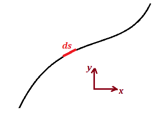

A disk rolls without slipping across a horizontal plane. The plane of the disk remains vertical, but it is free to rotate about a vertical axis. What generalized coordinates may be used to describe the motion? Write a differential equation describing the rolling constraint. I've attached a picture below.

I'm supposed to end up with
\begin{align}cos\phi dx+ sin\phi dy &= d\theta r\end{align}
and
\begin{align}\frac{dy}{dx}=tan\phi\end{align}.
But I'm not sure how to get (2). If I differentiate (1) w.r.t. ##x## and if the terms with ##\frac{d\phi}{dx}## disappear, I'm still left with ##cos\phi + sin\phi \frac{dy}{dx}=0##, which won't get me to (2).

Your working should have partial derivatives in a few places.
Looking at the diagram, it seems self-evident that the angle φ is the current direction of rolling, i.e. tan φ=dy/dx. But I don't understand how in your working you substituted cos φ for x/R and sin φ for y/R. That would imply y/x=tan φ.

@theshape89 :
The disk moves along some curve in the x-y plane:
Consider a small element ##ds## of the curve. Let ##\phi## be the orientation of ##ds## relative to the x-axis.
You should be able to get equations (1) and (2) of your first post directly from this triangle and how ##ds## is related to the radius of the disk ##r##, and the amount ##d\theta## the disk rotates as it travels along ##ds##.
