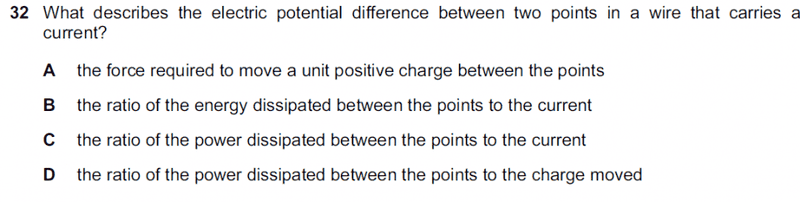

The answer is B, though I thought that electric potential difference is the ratio of energy to charge? Why is the answer stating the ratio of energy to current instead?
Are you sure the answer is B ?
Oops, so very sorry. Read the wrong answer. Answer is C. Sorry again
