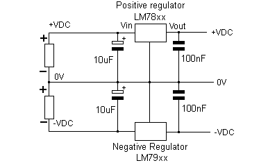

you can make a dual rail supply from a single or 2 batteries like this ...
single battery or other single rail supply
2 batteries ...
Note that in the first one, two resistors are being used to produce a voltage divider
this is for small currents only as the resistors produce current limiting
so if you had, say, a 12V battery, you could produce a +6V, 0V, -6V supply
the second dual rail supply uses 2 batteries with the addition of voltage regulator IC's to produce a stable outputcheers

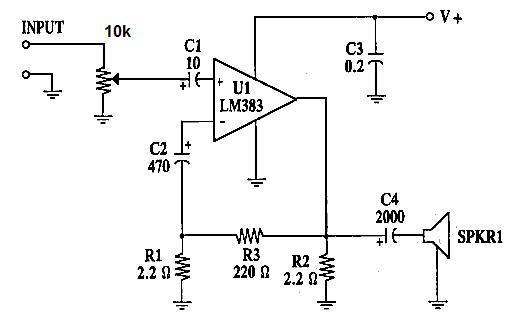

And one last thing.. How do I know the output of my smartphone headphone connector? DC level, peak AC, etc? Because most LM383 circuits set a gain of 100, and I want to be able to vary that gain to drive the 8 ohms speaker at 6-8 watts.
8 Ohm speaker running at 6W means approx 10V peak output voltage. So I need to know the input so that I can play with the gain.
Put a potentiometer in front of the input.

just like this, using the circuit you linked to...

But wouldn't that be just like attenuating the input and having same gain.. What if I needed more than the full input voltage, I need more gain right? So I thought knowing the output of the jack would be better.
Yes.
That is the way it is done on pretty much every amplifier ever built
so if the amp has a gain of 100, you can work out the output power relative to the input power
you ONLY get max output from the LM383 ( or whatever other amp) WHEN its input is driven fully
you cannot overdrive the input to the amp it will just produce an unlistenable distorted output and possibly damage the amp chip
the full output of the headphone jack of your phone/media player could easily have enough output to overdrive the amp chip
so that is why the volume control ( attenuator) goes on the input to the amp

The other circuit features two regulators, what if I omit them.. If I have the battery of the voltage required?
yes that is OK, the reg's in that circuit were just a progression for if a well regulated supply was needed ... feeding IC's for example

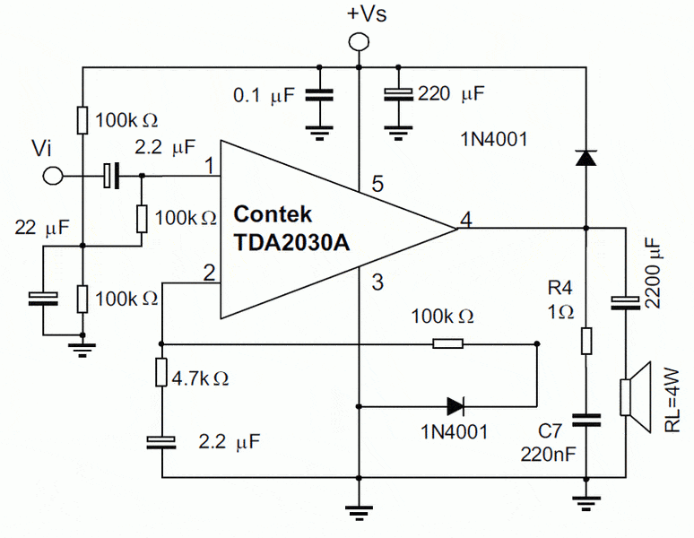

This amp IC (in the attachment) , is expected to deliver around 8W to an 8ohm load. That means the rms output would be 8v.
1) looking at the circuit, the gain must be decided by the 150k & 4.7k divider, which gives a gain of ~30. (Am I right?)
I learned the headphone jack has a max output of 1v rms. This means the output of the amp would be 15v at half input. This exceeds the figure given by the amp manufacturer. Am I wrong with the gain?
2) What is the use of those diodes going from the output to the supply? Are they a kind of protection? Do I need to incorporate them compulsarily?

The amplifier :
so you can adjust those resistor values to give a useable gain
Also I think I mentioned in an earlier post, you should have a volume control in the input for gain adjustment so that you don't overdrive the input to the IC and cause distortion
these diodes are for the protection of the IC from voltage spikes on the output
Note for a single rail PSU, as you are using, here is a valid connection for them ...
also note, this chip is capable of around 12-14W for a 4 Ohm load and up to 18W for a 8 Ohm loadDave
