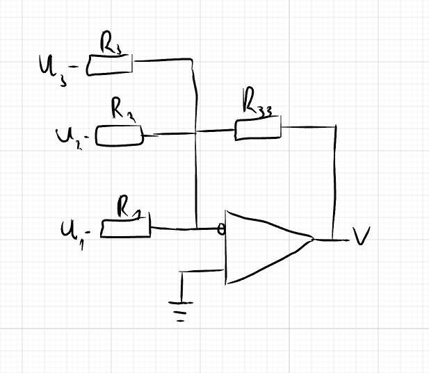

I need to create circuit of this operation on three voltages:
We'll use circuit of voltages summer:

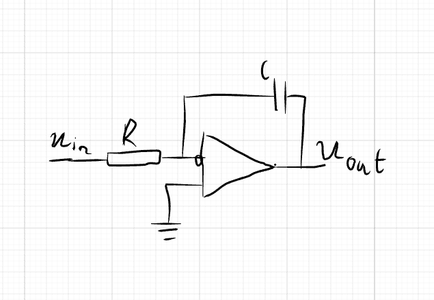

The third term is the integral of U_3, so we'll use integrator:
Than, calculate capacitance:
And on this step we have negative capacitance. Is it possible? Or I did something wrong?
Next, we calculate R_1, R_2.
And here we have -44 kilo Ohm for R_2.

The negative sign comes from the simple op-amp based Miller integrator inverts the signal. If you want to cancel the negative sign, you will need to invert the signal in that branch, before or after the integration.
