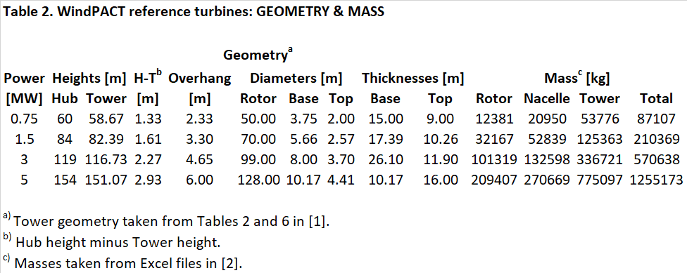

Let me tell you more about my project. In a first stage, I just want to define a simple (but representative) base line for loading and geometries in order to compare different lattice tower configurations in some meaningful scenario. Thus, I decided to deduce myself the thrust formula and collect the necessary data from the WindPACT reference turbines (Tables 1 and 2).

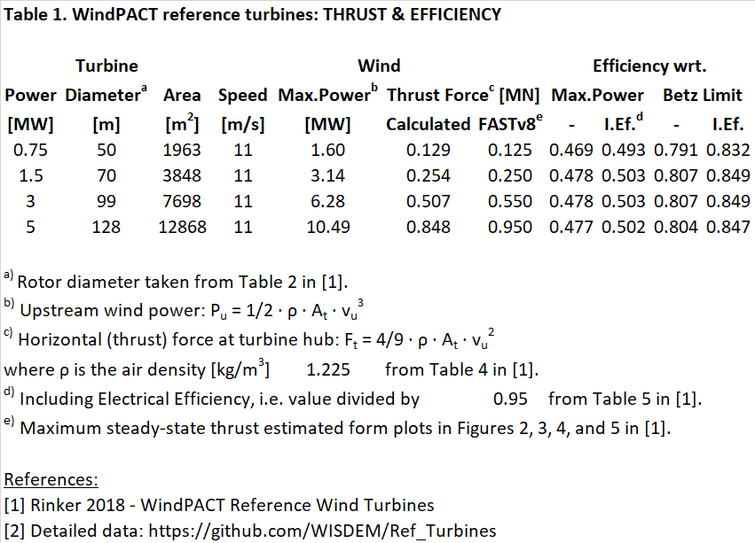

With this data I tested how accurate the thrust predicted by basic physics (see formula "c" in Table 1) is in comparison with WindPACT paper. As it can be seen, the calculated and FASTv8 results match fairly well. In addition, I could check that these turbines are working at nearly 85 % of the Betz limit efficiency.

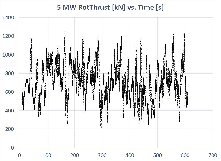

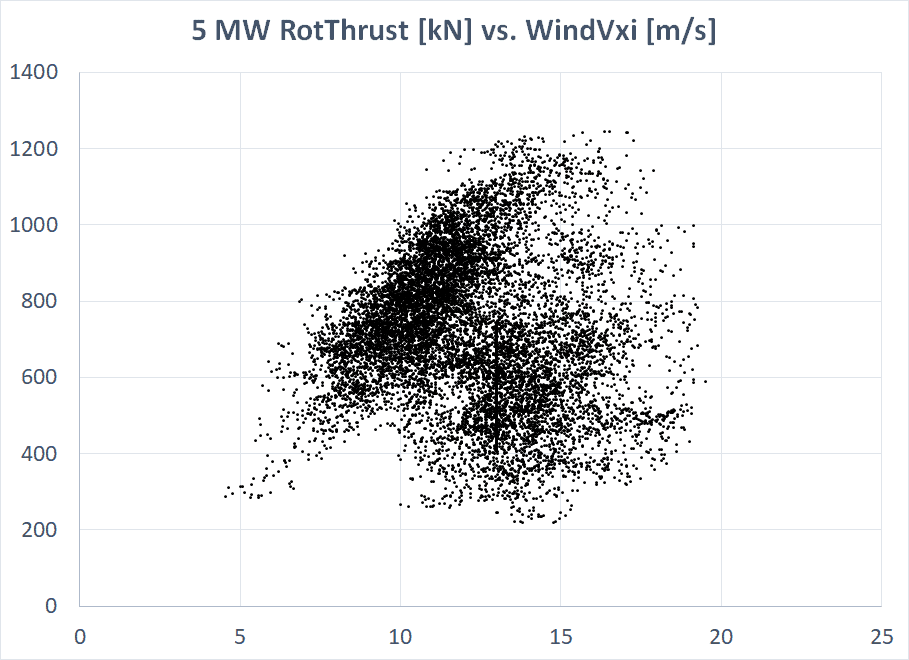

I also examined some of the pre-computed simulations from the four reference wind turbines to better understand what I would do and decide what to do next. For example, I plotted Thrust vs. time (Figure 1) and Thrust vs. wind speed (Figure 2) for the 10 minutes simulation for the 5 MW case.
Now I realize how complex the aero-elastic interactions between all turbine components are and why many long simulations are required. One question about all these stuff, do you know how the steady state thrust in Rinker 2018 (pages 13-14 or column FASTv8 in Table 1) was calculated? In the pre-computed data for the reference turbines (link above) I haven't found any clue.
