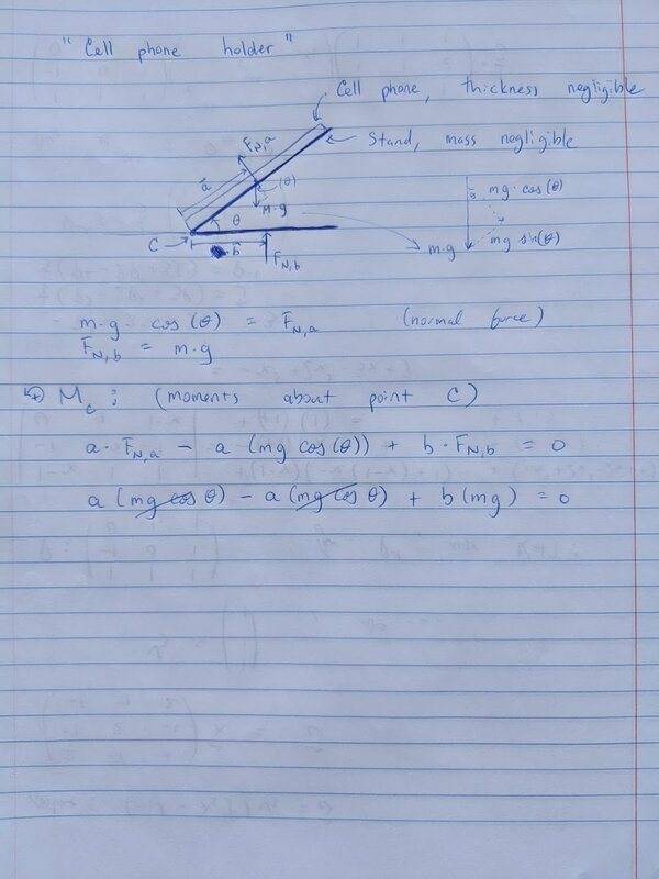

I am trying to design a simple cell phone holder that will be printed using a 3D printer. For this phone holder I would like the base to be the minimum length possible to avoid the thing tipping over backwards. I drew a simplified slope and base which represents the phone on the stand, but I am pretty rusty on my mechanics and I think I am making some incorrect assumptions in my problem.
For the problem I am assuming the holder is rigid, the thickness of the phone is negligible, and the mass of the holder is negligible. I did not show it in the drawing but there will be a little ledge at the bottom to prevent sliding down.
I have attached my attempt to solve for the length of the base, but as you can see my solution is nonsense. Is anyone able to see what I am doing wrong?
Thank you for your help. In exchange I'd be happy to print someone a cell phone holder once it is complete. (Or any other printable CAD file you provide. Then maybe I will feel like slightly less of a mooch in these forums).

If the holder has low mass, the combination will have a high centre of mass.
It will then only sit on an absolutely flat surface that is steady.
If you minimise the area of the base it will fall over.
It needs a large area, heavy base, and a full set of design specifications.

What are the dimensions of the phone?
What force must the phone oppose without falling? Directional?
What is the mass of the phone? Where is the centre of mass?
How is the phone attached to the holder?
Why make a bent flat sheet when you can introduce a corrugation or an edge lip that will provide greater rigidity?

PS "a", "b" etc are labeled in the drawing as your "specs". I'm sure you're familiar with solving such equations so that numbers can be plugged in later. I'm solving for "b".
Mass is "m", as labeled in the drawing. It's just a preliminary calculation I was trying to get help with.
Sorry if we were harsh. You want to design a "good" cell phone holder. Why is the minimum length base good? The shorter and narrower the base, the more likely it is to tip?
@rudy, if you are still around, some further simplification to the problem may get you started.
Try the worst case that someone will push down on the top edge of the phone (maybe it has a touchscreen, or a charging jack up there). That indicates the base needs to reach under the top edge of the phone.
If the phone buttons are pushed horizontally (left to right in your sketch) with enough force, the stand will either slide on its resting surface or tip over from the torque. The torque of course will be the product of the horizontal force and its distance above the resting surface.
If the phone buttons are pushed at some angle between horizontal and vertical, the resultant horiz. & vert. forces can be determined using SIN and COS of the angle and the applied force.
(sorry, too lazy to write the eqs. and solve the problem)
Cheers,
Tom
