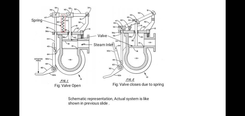

I want to design cross section area required for valve stem when valve is closed under spring force. Valve stem should be designed for buckling load but I am unable to calculate buckling load coming due to impact force coming when valve bangs on valve seat.

We need to see the configuration of the valve assembly, it is clearly not a conventional ASME type safety/pressure relief valve design.
I am trying to design a cross section of valve stem and check its safety against buckling load.
This is schematic representation of emergency trip linkage from US patent:US4379544.

The spring is not the primary source of the valve closing it is the ΔP across the valve disc as approaches the valve seat that actually drives the valve closing and sealing. As a result stem load due to the spring load will be relatively low because the spring is only required to overcome the differential lifting force of the stem area x the system pressure to start the valve closing.
The primary source of the valve closing is the ΔP across the valve disc as it approaches the valve seat, which will reach a maximum force of F = ΔP x (the valve disc diameter) + the kinetic energy of the closing stroke. Your main focus should be on the stress on the valve disc upon closing because it can be very high depending upon the ΔP between the valve inlet pressure and outlet pressure at valve closing.
I am speaking from experience from developing an ASME Section 8 Pressure Relief Valve with a metal seat and disc and similar "bathtub plug" type of closing action. It took almost 6 months of engineering analysis, including FEA, and cycle testing focused singularly on incorporating the necessary closing cushioning to provide a design that would allow the valve to close and still have a reasonably long cycle life without damaging the disc and the seat sealing.
Admittedly, that valve is designed for very high pressure and temperature steam service, i.e. 900 psig @ 1000°F; but, point is that in this type of valve the seat disc will be very highly stressed and must be carefully designed to prevent disc overstressing upon closing. For reference, see US Patent No 5,011,116.
Just as another comment on the use of your valve, due to its design, once that valve is closed it will not possible to reopen it until the system inlet pressure is reduced to that of the outlet pressure with the valve closed.

Thanks for the insights. It is not a pressure relief valve. It is emergency valve of steam turbine which will required to be close the valve as soon as there is application of actuation force as shown in figure 1.
And steam is trying to open the valve. So only force which is closing the valve is Spring.
Now, I am trying to design the valve stem since it will be acted upon by impulse generated when valve closes.
As already asked in other thread, I was unable to calculate the force of impact analytically, the same has lead me to ask this question again.
Please let me know quantification of force estimation unlike qualitative way or how can I analyse this in FEA.
And It is pilot operated valve though figure doesn't show it explicitly.
Please Note: I have one concern about your above post, your valve drawing states that the "steam inlet" is the right side connection, which indicates to me that when the valve is closing or closed it is stopping flow from that inlet to the the lower pipe. So, unless you are trying to use your valve to block a reverse flow form the bottom pipe to the side "steam inlet"inlet, then all of my above still applies because it is the closing action, not the opening of my referenced valve, that creates the high impact disc stress.
If the reverse flow blocking I just described is the case, the only impact stress will be from the spring's stored energy with the valve open plus any spring's designed residual load at the valve's closed position.
To determine the impact force on your valve stem and bottom disc center, start by calculating the spring's potential energy in its stretched condition by PE spring = 1/2*k*h^2; and, that is the energy that will be delivered to the top of the stem and the disc at the bottom when the valve closes.
Then by using FEA, or a classic analysis (See @ http://www.roymech.co.uk/Useful_Tables/Mechanics/Plates.html for a sample "disc with a simply supported O.D. and a center load" analysis) determine the k disc for your disc. Then the PE applied to your stem and disc center will be equal to the above PE spring.
Next, using your established k for the disc loading; then, your: impact h disc deflection = sqrt(2 * PE spring / k disc); and, from that F impact = h disc deflection * k disc.
Next add to the above the force on the stem due to any residual spring loading after the valve closing; and, the sum of those two loads will be the total load on your stem top, as well as, on the bottom stem connection to your disc center.
Note: There will be some additional damping to reduce the above impact force due the compression stress on your stem that I have not included in this analysis; but; the above procedure for determining the disc deflection can be applied to the stem and then the total deflection used in the final F impact equation will be the sum of the stem and disc deflections.

Here, please note, steam is present on above and below the valve disc in running condition. Valve needs to be closed against the effective unbalanced area (which is area of stem) on which steam force is acting in upward direction and spring closes against this force.
For worst case design, when no steam is admitted, valve will be impacting on valve seat due to spring energy.
I have considered the case of simply supported circular plate with load at center (Case 1 in the link you had provided).
The dimensions of valve disc considered. t=14 mm, r=38 mm, K_disc= Et^3/(0.552r^2)= 688506 N/mm
Spring stiffness considered= 17000N/m, and elongation in spring= 60 mm.
deflection of disc = 0.298 mm
Impulse force= 6888506* 0.298= 205271.93 N. It is very large force to be handled. I understand that we have ignored energy dissipation in valve seat and casting which are difficult to quantify.
What percent of energy of spring that will be directly transferred to valve is another big question.
Do I need to provide damper or disc spring on top of valve stem like a shock absorber?I had calculated the force of impact with with classical mechanics as F= change in momentum/ time
Time of impact of valve and valve seat , approximately considered as 0.001 sec since valve closing action completes in about 40 milliseconds.
mass of valve= 3kg
moment of inertia of lever system= 2.5 kg-m^2 about pivot.
Energy stored in extension spring= KE of lever system
0.5* 17000(N/m)* (60mm)^2 = 0.5* moment of inertia of lever system * angular velocity ^2
angular velocity of lever (to which valve and spring is attached)= 5 rad/sec
Linear velocity of valve = angular velocity * distance of pivot from valve = 5*0.14 = 0.7 m/s,
Force of impact = (mass of valve *(velocity before collision - velocity after collision))/ Time of collision
= 3* (0.7-0)/0.001= 2100 N
Conceptually this approach is correct but only glitch is time of collision!
How do I proceed further? Which is realistic value? The one suggested by former approach or the classical mechanics approach?
Please guide me. Thanks a lot in advance.
First, thanks for the update on what valve action you are actually addressing, that helps clarify my understanding of your problem. Ironically, because all of our pilot actuated POPRV's are pressure operated, I never considered the possibility of a zero pressure valve closing. Also, since I did not have your valve diagram in front of me while developing my above analysis I didn't even think to consider the operating arm in the analysis; nor, the force multiplication due to the lever effect of the spring connection offset from the top of the stem. I apologize for that and have now printed a copy of the of the drawing to have in front of me for future reference.
The amount of force the that is applied to the stem/disc center is what should be considered as the force delivered to the body valve seat since it is the item providing the opposing force to the impact. If you are concerned about the stress levels due to the current impact force then any added deflection between the spring and the valve stem, such as a disc spring, is one way to reduce the impact force and stem, etc stresses.
My best suggestion to helping resolve your conflict is to try performing the following third alternative impact force analysis to see how its result compares to your two prior analyses.
Use the average driving force of the spring (i.e. the average of the spring force with the valve open and the spring force after valve closing) as applied to the top of the stem; and, a consolidation of all of the lever assembly components placed at the top of the stem location; then use, a=F/m to establish the acceleration of that mass; and, since you know the valves closing distance: t = sqrt(2*s/a) and consequentially v = 1/2 a*t, then the total PE = KE = 1/2mv^2 applied at the top of the stem is established; and, as before:
Using your established k for the disc loading; then, h disc deflection = sqrt(2 * PE / k disc); and, from that F impact = h disc deflection * k disc.

Whereas with F=dP/dt , value is much less.
If you are referring to the average spring force calculation method, then yes it is a bit less and to be honest I would be inclined to use that; but higher the PE method result is a bit safer, barring an actual instrumented test.
I would not consider either calculated load value out of reason; so I suggest that you do the stem buckling, stem compressive stress and disc connection shearing stress and disc deflection stress calculations for both and forces to see their results; and, remember that for all of those analyses you must add the closed valve spring residual load to the impact load.
Keep in mind that because the stem has a buckling restraint just above its midpoint at the body seal there is a bit of an issue for the classic buckling analysis using the stem top connection (I assume you would treat the stem top connection as a guided end and the bottom disc connection as a rigid end connection but I am not sure how to treat the guiding restraint issue).
PS It is now 1:00 AM where I am so my responses to your further post(s) will have to wait until after I rise in the morning.
Thanks for the suggestions. And yes boundary conditions are bit of a challenge but force is critical issue.
One more thing, to absorb the valve shock, can we put disc spring on top of valve stem?
Let me know about your view.
Thank you for support.
Since protecting the stem is your primary concern placing a shock absorbing feature at the bottom of the stem is definitely worth considering; but, if your valve cap to disc space is very similar to that shown in the valve drawing you placed in this thread, it appears you are going to have a limited space for that modification. Placing the damping part feature there is easy but then adding the required disc to stem retaining feature without compromising the stem strength might be more difficult.
You can use the current calculations by substituting increasing values for the current calculated value to determine the required bottom deflection to protect your stem. In that respect, do mind telling me your stem diameter and the maximum expected ΔP across the valve disc when it closes under operating conditions.
PS From looking at our apparent time difference, if you need a quick turnaround post exchange on some issue, then your 8:30 - 9:30AM will be my 10:00 - 11:00PM so, depending upon your circumstances during that morning time, it might be a good time frame for starting one.
Like you pointed out about the space, rather than bottom, I want to put the spring on top of stem. Stem diameter is about 16mm (0.63in).
I want to know: will the valve force of impact be directly transferred to resetting lever through valve stem which needs to be absorbed by spring? Do i need to put the spring? Since energy will be dissipated in various ways like energy lost in casting of turbine, sound etc. How to I know, what percent of energy (rather force as I have to design a spring against this load) is reaching top of valve stem? Will the valve rebound? if so, putting spring at top of valve stem could be the solution. Let me know.
Approximating valve stem at resetting lever as fixed and valve as pin when it hits the valve seat, Buckling load I am getting as 40000N (approx). P= 2*pi^2*EI/L^2, l=400mm, E= 100GPa (At 400 degree C. Steam inlet conditions are 40bara/400degree Celsius) . Since the moment valve closes, pressure difference across valve is approximately null.
Sure, I am happy to know. Thanks.
First a some general items that I would like clarified before I respond to the stem spring design and valve rebound issues.
1.
I assumed the purpose of the valve is to block the steam flow to the turbine(s) in the event of a turbine system problem of some kind; if so, then there will be a pressure force on the disc = P inlet x (disc area - stem area). If what I assume is true then the steam flow, which has flowing inertia, will be able to deliver the full inlet pressure to the disc at the valve's closing point.
If the above is not the purpose of the valve being closed, then please explain its alternative purpose to me. The pressure force will not directly affect the stem loading; but it may increase the disc's deflection at the closing point and thereby reduce the impact force for the stem and actuator.
2. I have assumed that the mass of the disc has been included with the stem in the impact calculation. If not, then the closing assembly's currently calculated acceleration and therefore the impact force are higher than they will be if the disc mass is included.
3. Based upon your above operating pressure and stem diameter, the max lifting force due to the stem is 180lbs (800N) and that is at the top of the stem and if your lever design is similar to the Valve Schematic posted then the required spring is even lower due to it lever advantage over the stem. So, apart from the stem seal friction, why is your designated valve open spring force 258lbs (1147.6N) so much higher?
Now for your items I can address regardless of the above:
Any effect in reducing the impact force from the valve body will be minuscule because of its thick walls and therefore low stress and resulting strain from the impact force; so there is no help there and should not be considered in your analysis.
A Note of Caution: Be very careful about attempting to solve or reduce a problem with concepts such as the above without any verified calculations or data, because doing so has the potential to end up causing you real problems that never should have occurred. A bit of over-design is much better than the risk of a potentially under-designed one.
Yes , this is stop valve, so pressure difference has to be there across valve disc. I told null pressure difference just at the time of closure. I want to design for the worst case where to test the trip system, valve will be tested in absence of any steam. In presence of steam, impact will be lesser.
Yes i have considered mass of disc and lever too.
Well, from the data observed, Ratio of moment of spring force and moment of steam force about pivot, I have kept as 3. Closure time should be less than 0.5 sec or so (I had posted the question related to this too). I could not arrive at the stiffness of the spring required so I checked previous data and found this relation.
In static condition, just to close valve minimum spring force required = 360N with leverage.
