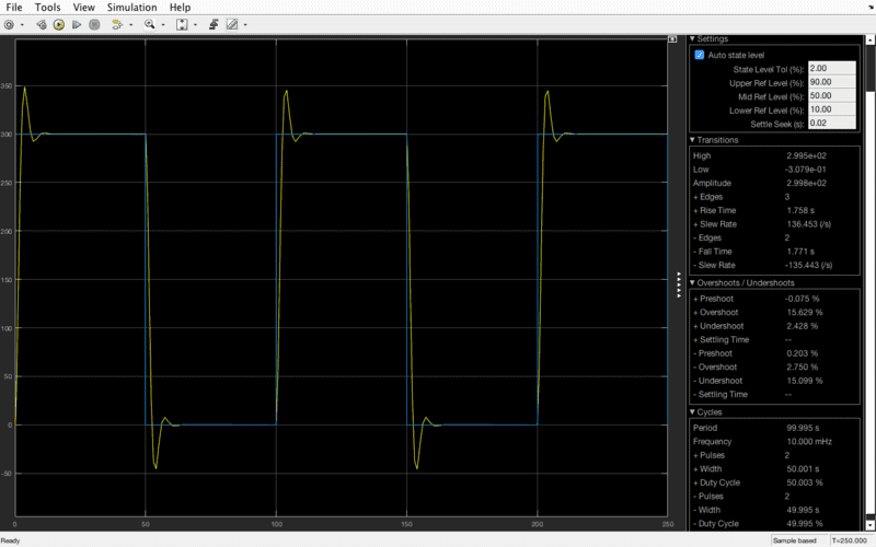

hi, below is the information of the system.
controller transfer function= ts/ks+k
motor transfer function (that is being controlled) = k/ts^2+s
where k= 0.4 and t= 2.7763
filter equation: s/(1/fc)s+1
when i first tried to control the motor by controller without using the filter i found that there are some oscillation and the settling time of the system increased. now let's say that i want my system to be free of the oscillations and improve the settling time so i think of adding a high pass filter but when i want to add a high pass filter then what should be the cutoff frequency of the filter that i must choose or how should i choose? @donpacino

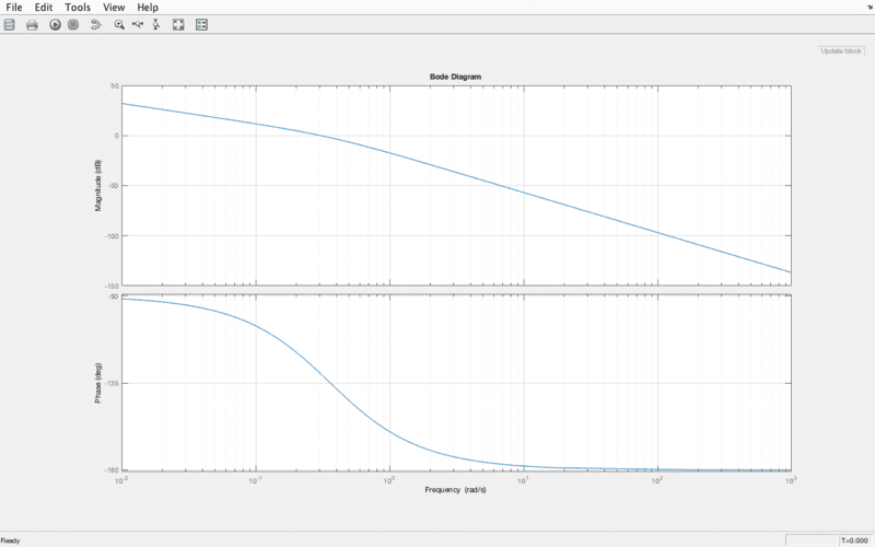

yes, its just a problem and values can vary too. yes, i read your post and i didn't understand much from the video too. attached is the bode plot and the signal characteristics of the system, after adding the filter at the fc=100hz. because i thought may be there is some way to prove that why fc is chosen as 100hz in reverse after having the system outputs and characteristics. but i m not able to prove this mathematically. so is there any way to get a relationship of fc with this available data?

ok I am going to reword a few of the things I've said...
1. your controller: ts/ks+k
I asked you to specify parenthesis. since you didnt make any changes, I can only assume your controller can be simplified to
[(t+k)/k^2] or [ (t/k) s/(s+1)]
either way these systems don't allow you to change the poles or zeros of your function. You shouldn't be adding a controller then a subsequent filter when the controller really doesn't do much. unless the controller is specified as part of the problem statement, which you didn't even tell me yes or no.
2. the hgih pass filter: like i said before the reason your high pass filter works is for reasons specified in the video. another way to put it is the phase and gain margins change, which change the poles and zeros of the overall closed loop system. but like I've said before adding a high pass filter is a bad way to do it. If you olny want to know mathematically why your trial and error method worked and don't care about the actual way to do it, then just know its because of the phase and gain margin changing and the poles changing.
3. If you don't understand that video, you should probably go backwards and take a look at the basics. lead and lag filters are an integral part of class control systems. If you can't understand them, you need to go back and take another look.

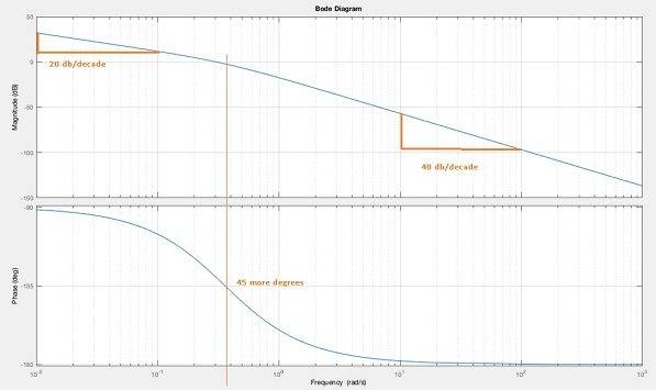

Is this the Bode plot you want to achieve ?
@jim hardy Yes, this is the Bode plot that i want to achieve.
