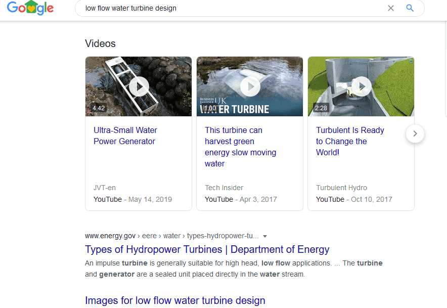

What about just Google searches with directed search terms? Have you been through most of the hits in this search, for example? I used Low Flow Water Turbine Design to get the search results:
https://www.google.com/search?client=firefox-b-1-d&q=low+flow+water+turbine+design
Likes jrmichler and TaylorHoward21
berkeman said:
Fun project! :smile:
