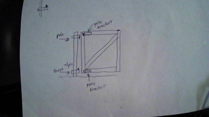

I'm in the process of repairing a wooden gate and would like to replace the wooden posts with metal ones, to help avoid the amount of sag over time. Both the gates are 59 wide by 50 height weighing about 25-50 pounds each(I don't have a scale to weigh it) made from pressure treated wood.

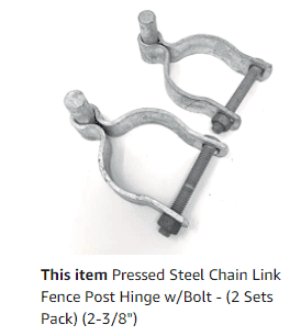

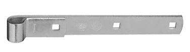

I want to use these parts to hang the gates to the metal post. My concern is the following:
1. How much torque to apply to the bolts on the post hinges to make sure it doesn't fall down the post.
2. Is 150 lbs Safe working load enough to support the gate. I will be putting 2 on each gate.
3. I live in an area where we've had winds gusts up to 75mph. Will this be sufficient to support the fence?
I can provide links if that is needed. Thanks in advance.

What do you mean by this: "2. Is 150 lbs Safe working load enough to support the gate. I will be putting 2 on each gate."?
Sorry, added another picture of the setup. Hope this helps.
The fence post hinges are designed to hold big chain link fence gates. Find out how much they weigh (my guess is they are at least as heavy as your gate).
You can torque those things pretty tight on the pole...if it starts to move tighten it up. The movement I have encountered is that they rotate on the pole. Tighten it up.
The usual failure point is of course not getting the post securely in the ground. Put it in deep and if possible pack good sized stones and maybe cement. I like to drill a few rods through the buried part of the pole to inhibit rotation. They also make surface caps to inhibit rocking at ground level. The rest will be easy.

The hinges should be OK. Not by engineering, but simply by looking :wink:
Your concern should be about stabilizing the pole. Two feet 'base' might not be enough without additional 'fixing', like connecting the top point of the pole to the fence.

From the picture (added after the initial post), the gates look to be well under 150 lb. apiece.
