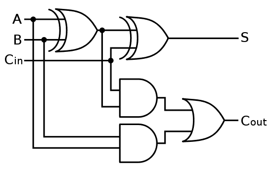

Does it do addition? Is that what you mean by 'adder'?

Svein said:
While that is a 2-bit adder it is designed with gates other than NAND. Granted I could simply replace each gate with the NAND equivalent, I kinda want to make this with the least amount of gates possible. Which is why I have come to this forum to see if I can get this simplified as much as possible.

Are you familiar with Karnaugh diagrams? ( https://en.wikipedia.org/wiki/Karnaugh_map )

I asked because a Karnaugh map is used for minimizing logical expressions with respect to gates.
Anyhow - check out https://en.wikipedia.org/wiki/Adder_(electronics) .

I think the main point was to use only NAND gates since they can perform the function of any gate...
Yes, You use the kmap to get the minimum logical expression, you then convert them to nand gates. You can also use the kmap and OLNY find nand gate connections
Likes jerromyjon
