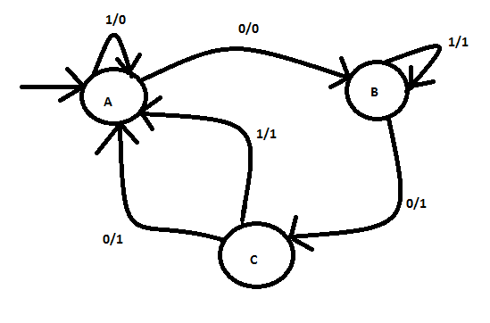

A dfa with three states has as input and output alphabet the set $\{0,1\}$.
Given the following input sequence and the corresponding output sequence , we should determine the automaton.
$ \text{ Input }: 00010101 \\ \text{Output: } 011001110$
First of all, the output should have a typo and we should ignore the last 0, so that the number of digits of the input and the output sequence is the same. Right?
Secondly, could you give me a hint how to draw such a deterministic automaton?

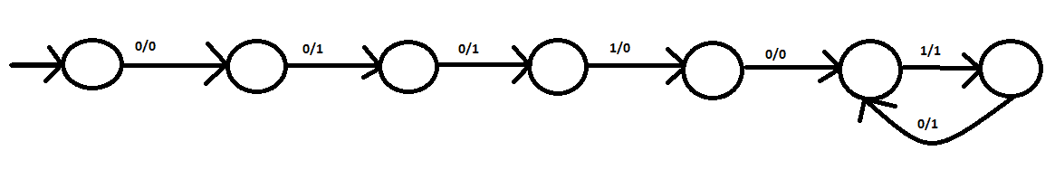

The dfa you drew is equal to the following one, right?View attachment 6077
Can we make further changes? (Thinking)
Yes. Although we don't have a final state anymore now... :eek:

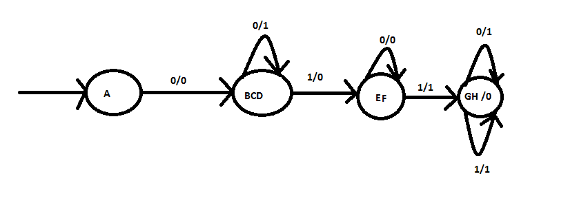

But now after we have printed 0 after giving 0, we can give how many 0s we want and the machine will print 1. Doesn't this matter? (Thinking)
No, because we're given what the input is. (Shake)
We just have to make it match the output without ambiguity.
If the input is $000101010$ and the output this : $011001110$ the desired dfa is of the following form, right?
Yep. Looks like it! (Nod)
