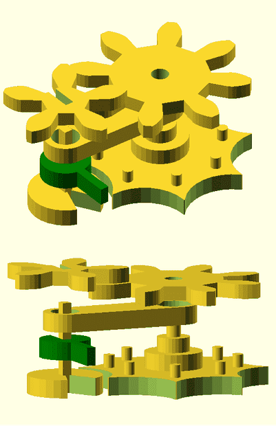

A while ago, I posted about a geneva mechanism I was trying to design.
My goal was to have the driving pin mounted on the driven wheel, pushing against something that doesn't move (either a dial pushing against some pins as in my latest attempt, or a gear with a single tooth pushing against a gear) to cause the intermittent motion.
An earlier attempt I posted:
as someone pointed out, this one lacked a locking mechanism.
I've designed one with a locking mechanism, which overcame a previous problem (dragging) but not my jamming problem - when the dial engages the pins/the tooth egnages the gear and the driven wheel is supposed to rotate, it gets stuck.
As can be seen in the gif I posted, if I cheat and rotate the gear mounted on the driven wheel myself (rather than driving it through a gear in the center), it works - not just in the version without a lock, but in the one with a lock as well.
I don't have a video of a version with a locking mechanism to share (I've allowed myself to lose track of the 3D printed pieces of some of the attempts because I planned on making more attempts before asking for help again, but my attempts to get my 3D printer to print properly have all failed so far)
my latest design (the one that I hadn't managed to print - a previous one with a gear instead of pins and a 1-toothed gear instead of a dial that I did print also didn't work)

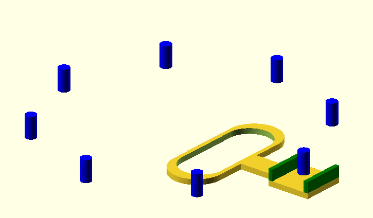

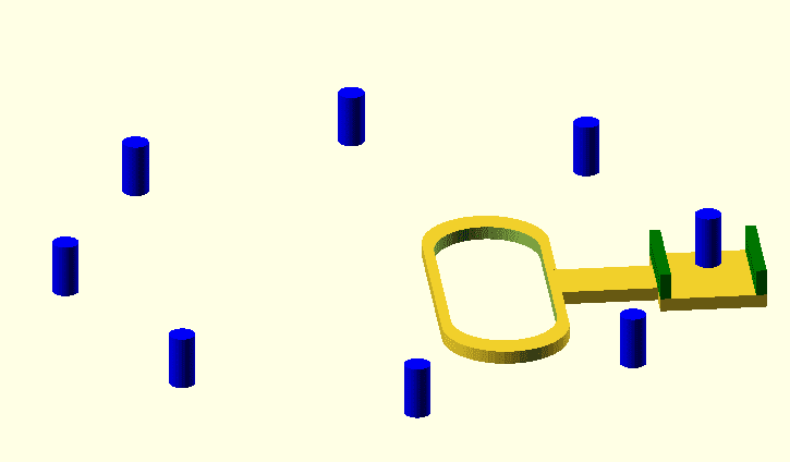

I have 8 pins uniformly distributed on a circle. I need to push, then pull each one of them sequentially, and I'm trying to use as few parts as possible (so having one mechanism for each pin is not an option).
I can't have a mechanism that is always engaged with the pins either - it needs to engage, push, pull, disengage.
To do the pull+push, I figured I would go with a scotch yoke.
here's a quick mockup:
I can't have the pin driving the scotch yoke rotate around the center axis, because I need to mount more things above it on the same axis. so since the pin driving the scotch yoke can't rotate around the central axis, I came up with the idea of having a geneva mechanism with the driving pin/dial (the green part in my geneva mechanism design) mounted on the geneva wheel, and I will have the pin driving the scotch yoke mounted on the same axis as the driving pin for the geneva mechanism.... I hope that all made sense

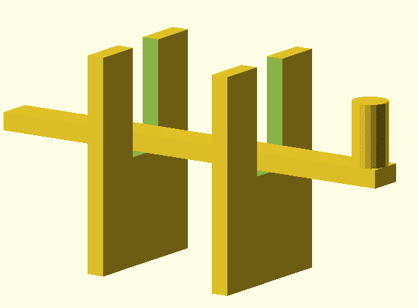

I would arrange a single rotating actuator disc with a cam that pushes the pin away, with a small rocker or guide operated by the same cam to push the pin back.
The critical thing about the design is the connections to the circle of pins. How do they extend up and down? Without that detail, it is not possible to see solutions that are simpler than the Geneva mechanism.

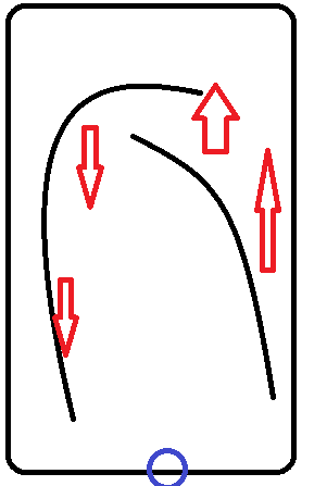

I considered a mechanism that was purely a cam in the past
Imagine this rotating around the blue circle. The curved lines within the square would be raised, and it would push and then pull the pin back as it rotated.
This would've been ideal - incredibly simple, with one piece. But I tried it, and it applied too much force to the side and not enough up/down.
To make it work I would have to make everything too big so the lines would have an angle that would impart more force in the forward/backward direction.
(I also had no idea how to design the ideal curve as a function of the angle over which I want it pushed forward and then backward. The forward+backward motion has to be completed over 45 degrees, and I'm guessing the force applied forward and to the side depend on the cosine and sine of the angle at the point of contact...)

... although I am getting a new idea now
I could have a gear as part of the green part (pin+lock) to drive a gear mounted on the same axis as the output, which, in turn, will drive the mechanism I would use to do the push+pull
here star = gear, and the blue gear would be mounted on the output wheel (red part) and operate whatever mechanism pushes and pulls.
... I'm a bit disappointed with myself for not thinking about this earlier. It was so simple
