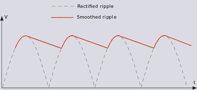

Design, giving the necessary ratings and characteristics necessary for the transformer, bridge rectifier, reservoir capacitor and regulator, a 12 V, 2 A regulated power supply. Also identify any heat sink requirements. The available mains supply is 230 V ±10% @ 50 Hz.
So far I have:
Desired output + diode drop + allowance for regulator +10%variation in supply
(12V+1.4V+2V)+10%=16.94V RMS
minimum Vs_peak=16.94(sqr(2))=24V
I have so far gone as far as working out the minimum secondary winding peak voltage.
I have 2 answers working differently so I would like to clear something up before I can proceed.
I have used in the method posted above 1.4V for diode drops and 2V for regulator headroom. My calculations are done in RMS before finding the peak. Should I change the 1.4V and 2V to RMS or are they assumed to be already?

The output of a bridge rectifier and capacitor looks like this...
https://en.wikipedia.org/wiki/Ripple_(electrical)
At the bottom of the ripple the voltage must still be above the minimum needed for the regulator so you need something like..
Peak voltage = Desired output + headroom for regulator + ripple voltage + diode drops
If you use a big enough capacitor to make the ripple small you can approximate the ripple voltage using..
I = CdV/dt (which comes from Q = CV)
so
dV = Idt/C
You know I is 2A, you know approximate dt from the period of the waveform. Pick a value of C to give you a modest ripple voltage.
Also.. Power diodes typically have a higher forward voltage than signal diodes. Could be 1.2-1.5V per diode rather than 0.7V. Perhaps have a look at a few data sheets for diodes in the 2-10A range.

That procedure isn't bad but its normally more of an iterative process..
The voltage you calculate at step 3 is a lower limit below which the linear regulator stops working or "drops out". So you cannot specify that as the peak voltage. You must shoot for a higher peak voltage to allow for the diodes, the issues mentioned in step 6 (10%) and a budgetary estimate for the ripple voltage (perhaps 1V).
Steps 7 and 8 are usually done together. For example you normally calculate the minimum capacitance required to reduce the ripple voltage below the value you budgeted for earlier. Then you round up the calculated capacitance to the nearest standard value and finally recalculate the actual ripple current that will occur with the chosen capacitor.
