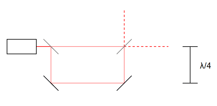

The issue of total destructive interference is sort of like the issue of perpetual motion machines. On the one hand, you can argue from first principles (conservation of energy) that it's impossible. On the other hand, for specific scenarios, it can be difficult to pinpoint exactly where the flaw is.
The scenario that had many people puzzled for a long time was the use of beam-splitters and mirrors to get total destructive interference, as shown in this diagram
(The discussion is here: http://physics.stackexchange.com/questions/88422/fully-destructive-interference)
It would seem that by adjusting the lengths between mirrors, we could get perfect cancellation for the parts of the beams shown in dotted lines (if we assume an ideal case of a beam splitter that passes 50% and reflects 50%).
I don't remember the definitive resolution, but in discussions about the problem, someone pointed out something that I didn't realize (I'm assuming that this person knew what he was talking about): The phase shift resulting from reflection off of a partially silvered pane of glass is different, depending on whether the light reflects off the outer surface or the inner surface. For the mirror in the upper right corner of the setup, one beam must reflect off the inner surface, and the other beam must reflect off the outer surface. So they won't have the same phase shifts. That is enough to spoil the possibility of perfect destructive interference.
I'm going to do a little Google research to see if I can find a definitive statement about the phase shift from reflection off inner and outer surfaces.
