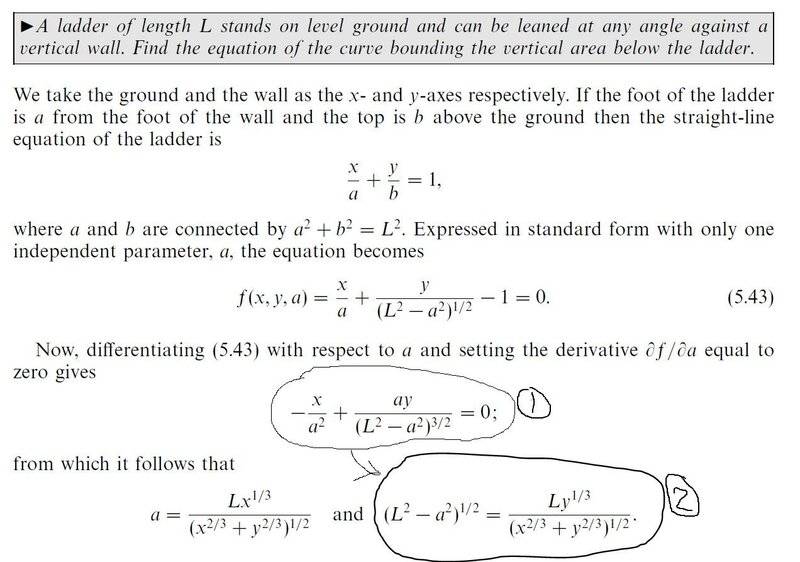

I am looking for steps for the solution of an envelopes example in Mathematical Methods for Physics and Engineering book
Can someone please show me the steps from circled equation 1 to 2?
Thank you.
If you replace ##x \leftrightarrow y## and ##a \leftrightarrow b## in the previous equation, you get the last equation.
Likes vgarg, DrClaude and Orodruin
To clarify: By the symmetry of the problem, you could have solved it for ##b## to get
b = \frac{L y^{1/3}}{(x^{2/3} + y^{2/3})^{1/2}}
instead of
a = \frac{L x^{1/3}}{(x^{2/3} + y^{2/3})^{1/2}}
Then simply substitute ##b## in the first equation using ##a^2 + b^2 = L^2##.
Likes vgarg and Hill
