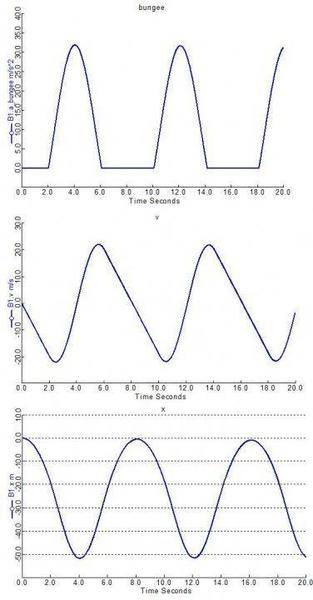

We did a bungee jump thread a year ago. It's somewhat the same set of equations. I kept the simulator file; here's a picture:
Jumper m = 100 kg, starts at 0 m with 0 m/s ; chord is 20 m long and has k = 100 N/m
Top: acceleration of the jumper due to the chord (he also experiences a constant -9.81 m/s2 from gravity). Chord is taut after 2 sec.
Mid: speed in vertical direction. So after 2+ sec (when a_bungee > g) speed is at a minimum.
Bot: vertical position. Sine wave for x < -20, parabola for x > -20.
Your accelerometer gets a huge shock when the jumper hits the mat, so at t = 2 sec you get a huge negative peak, hopefully short, but probably with some nasty spikes (hence my low-pass idea). Then it follows the positive sinusoid and when the jumper leaves the mat you get another negative peak and some oscillations.

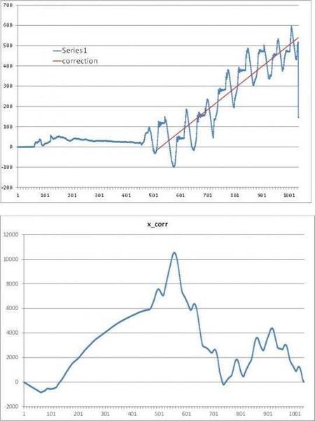

I attach the chart of acceleration on z axis of 10 jumps.
I also attach two cvs files with the measurements.

Quite a bit to say about this ! I think the 6.25 Hz isn't very useful: the signal saturates at both ends -- why at different levels at the positive side is somewhat mystical to me. The -20 V is from some supply voltage I would guess.
The 400 Hz looks much more promising, but also saturates at the - 20 V level. Something that should be fixed before any sensible signal processing can be done.
I subtracted the average ( whole 1035 points sequence - 9.229, quiet period 200 - 400 : -9.77, I fiddled and added 9.729) and 'integrated' to get speed (top picture). Not spot on, quiet period should give 0.
And the horizontal sections while the 'bouncing' is in progress aren't at the zero level at all -- a sure sign that the saturation at - 20 V is a real nuisance because it builds up. But they are nicely distinguishable, so that's encouraging. At the end of a quasi horizontal section, the speed goes up first, then down. Doesn't look like post 7 (the 'up strokes' -- when the acceleration of the 'bouncer' :smile: in post 7 is > 0) at all. A sign problem ?
I tried to correct a little (red line is linest fit from 515 to 1035) and then integrate to get 'x' , but you can see how the offsets/drift spoil the picture.
Still, the parabola-like shapes (albeit upside-down !?) are clearly present.
First thing to do: get rid of the saturation. A voltage divider between sensor and detector should do the trick (if the input range can't be adjusted otherwise). Then try a similar signal analysis again.
"Why should care about it ?" Gives you a start if you need to do some frequency filtering. And a little understanding never hurts ...
So how's our bouncer doing ?
