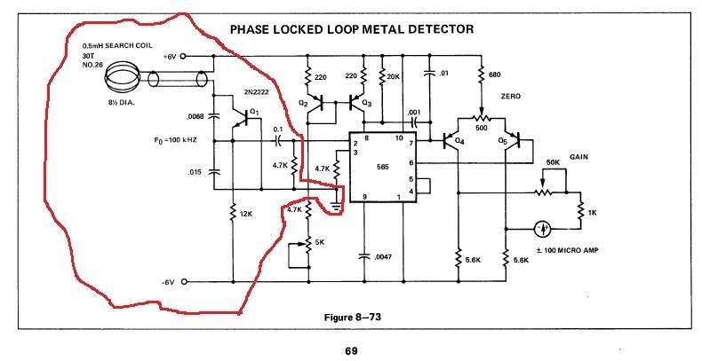

Here's a metal detector schematic - i circled the oscillator section in red...
it runs pretty close to 100khz
It'll change frequency when inductance of the coil changes.
@rbelli1 suggested such an approach.
242955
source:
242956
your search engine should find the book. I suggest download a copy.
Circuit operation is described on page 68.
old jim
That's cool, thanks. It even gives number of turns and diameter for the coil. Only disadvantage, it needs a battery. So you reckon a passive circuit should be ruled out? What's that meter doing when it measures capacitance anyway?
