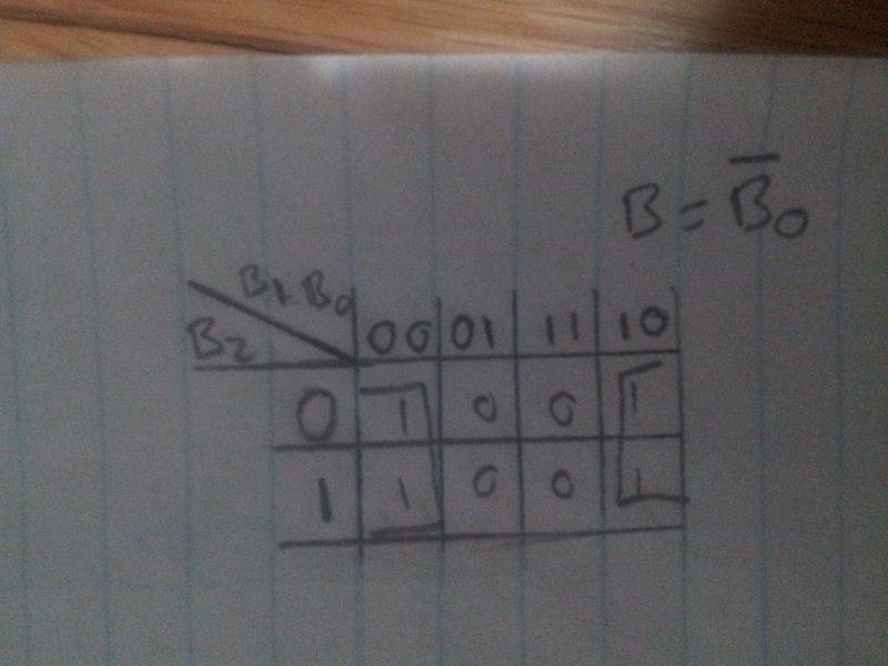

Here are my Kmap for input A and B.
You had it right in your statements and now you are complicating it. Why?
I don't know, but here the final equation:
F = /B0 * /A0
That looks right.
lewando said:
That looks right.
Really? How about when both numbers are odd?
if both numbers are odd it would output 0 since I am only checking the least significant bit. and the least significant bit in odd numbers will be 1. and 1 * 1 would output 0 since there are NOT gates in both inputs or am I wrong ?
