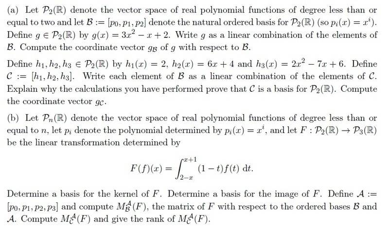

Hello I have a question about part (b)
Now I know that F(f)(x) = [##\frac{1}{2}a+\frac{5}{6}b+\frac{17}{12}c]+[-a-2b-4c]x+[b+\frac{7}{2}c]x^{2}+[\frac{-2}{3}b-\frac{7}{3}c]x^{3}##
so Kernel of F : F(f)(x) =0
=> ##\frac{1}{2}a+\frac{5}{6}b+\frac{17}{12}c=0##
##-a-2b-4c=0##
##b+\frac{7}{2}c=0##
##\frac{-2}{3}b-\frac{7}{3}c=0##
which gives a=3c,b=-7c/2
so the basis for the kernel of F is (3,-7/2,1)
I think it is correct.

The basis you found for the kernel of F is correct.
To find a basis for the image, you might start by finding a set of vectors that span the image of F and then find the largest subset that's linearly independent.

Sorry, I misspoke earlier. The image of F isn't four-dimensional; it's a subspace of a four-dimensional space. My point was that the vectors in Im(F) should have four coordinates, not three, as you seemed to have inferred.
If you rewrite what you wrote earlier for F(f)(x) slightly, you get
F(f)(x) = a(1/2 + x) + b(5/6 - 2x + x2 - 2/3 x3) + c(17/12 - 4x + 7/2 x2 - 7/3 x3),
which you can interpret as a linear combination of three vectors. Hopefully, that's what you did to come up with the vectors above.
The vectors (1/2,-1,0,0) and (5/6,-2,1,-2/3) are linearly independent and span the image, so they are a basis for Im(F). There are two vectors, so the dimension of the image is 2.
