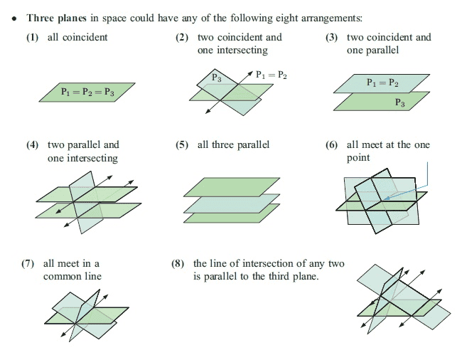

To elaborate on the above, and omitting knowledge about whether the equations are independent, if we have three equations in three unknowns, we could have:
No solutions
The system of equations is inconsistent. Geometrically, the planes are all mutually parallel.
Exactly one solution
The system of equations is consistent, meaning that the reduced row echelon form will have a leading entry for each row. Geometrically, the three planes intersect in a single point.
Infinite number of solutions - can occur in two ways
The reduced row echelon form will have one row of zeroes. Geometrically, the three planes intersect in a line.
The reduced row echelon form will have two rows of zeroes. Geometrically, the three planes all intersect everywhere (the three equations all represent the same plane).
Likes FactChecker and sysprog
An illustrated list of the possible geometric arrangements (found on stackexchange):
