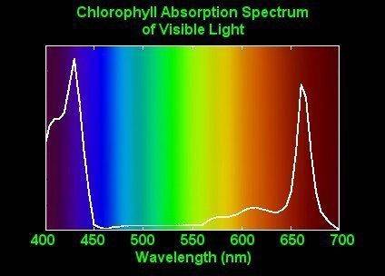

Eventually I wanted to try to use the 660nm LEDs to grow some plants
Me too! I've been thinking about it for over a year now. [ref: PF]

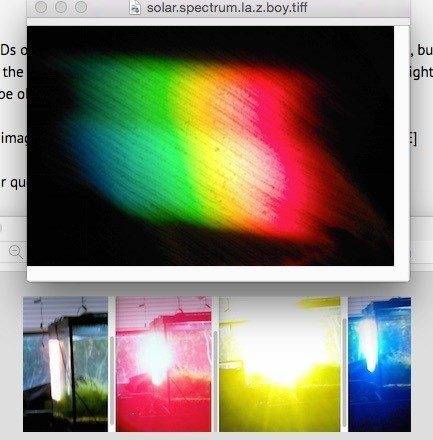

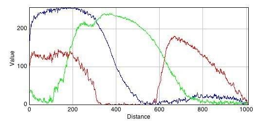

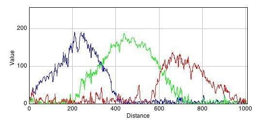

I just did this experiment. The RGB values are of no use, IMHO.
A couple of weeks ago, my fish tank cast a rainbow on my La-Z-Boy, so I took a picture. I also took pictures of the light coming out of the fish tank.
I just now took a snippet of the red section from the La-Z-Boy image, and the only thing it told me, was that everything was red.
It would be interesting to see how accurate this would be. Would the image compression affect the RGB values (TIFF vs JPG)?
My camera is quite, um, "inexpensive", and only takes JPG images. But, I think it's a moot point.

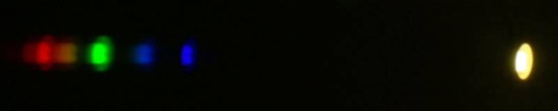

Lotic7 said:

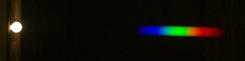

How well would a digital camera work in analyzing the spectrum?
Very well: I took these by simply placing a diffraction grating in the optical path
That's the spectral output of an incandescent light, and on my camera, the full size the spectrum covers 950 pixels. There are some subtle aspects (the shape of the light is convolved with the rainbow), but if you have a standard spectrum, you can indeed make quantitative measurements. A good standard is the output of a fluorescent bulb:
Each emission wavelength has a clearly identifiable location- overlaying an image of the LED will give a pretty good estimate of the output spectrum. Even so, I have to mention that I'm not sure what the measurement limitations are- can I distinguish between 660 and 650 nm? Unclear, but that's why I have a spectrometer in the lab.
Edit: OmCheeto's link describes essentially what I did.

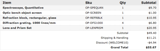

Save your money for a diffraction grating. A CD or DVD works fine.
Thanks Andy, that's a good site. They have spectroscope for under $10.
Andy Resnick said:
CD/DVD are not transmissive gratings and have curved 'slits', complicating everything. Transmission gratings are so cheap as to be nearly free:
http://www.hometrainingtools.com/di...e=2&fep=2082&gclid=CNTn4f-TissCFQEGaQodrpUIIw
We buy then by the case.

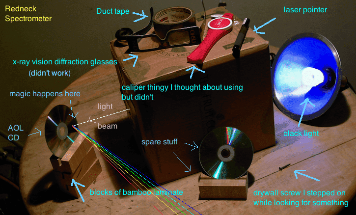

Beings how today yesterday was Sunday, and the store that sells diffraction grating was closed, I decided to try the CD approach.
I now can appreciate why there are "optical benches", as my data is somewhat boogered.
I'll try again in the morning.

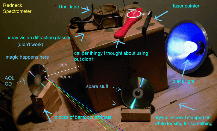

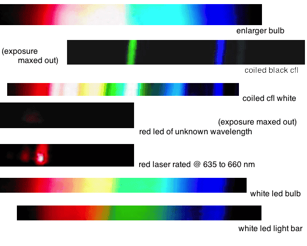

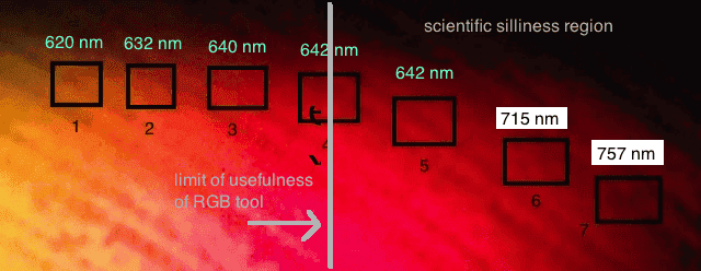

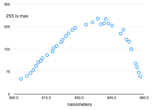

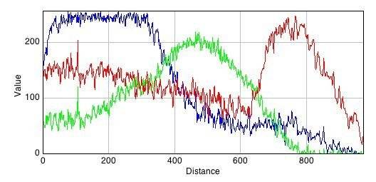

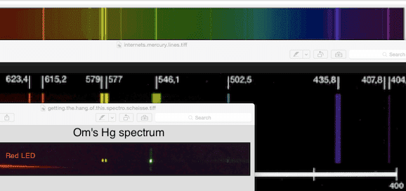

While I'm collecting new data, I thought I'd share some notes, images, comments, retractions, excuses, and theories as to what the heck is going wrong.
Notes:
1. My camera is old and cheap. The only adjustment available is "focus", which consists of markings: "Flower"(1 ft), "Mountain"(∞), and a "4 feet" line, which I drew on with a sharpie pen one day.
2. When overloaded, my camera turns colors white.
Images:
1. In the course of the experiment, I rounded up 7 unique light sources from around the house, of which, I collected spectral images:
Comments: Looking at the first raw images, I didn't think this experiment would work.
But, I would discover that the fact that my camera had 2560 x-axis pixel resolution, would yield ≈1 nm information, based on:
white LED bulb range
x-axis____ limits of visible range
1418______22 pt red
1702______64 pt blue
284_______difference​

Retractions: I may suffer from multiple personality syndrome, as, well...
Om; "...everything was red"
Everything was NOT "exclusively" red.​
Om; "The RGB values are of no use, IMHO"
Thank god I included the "IMHO"...​
RGB values are somewhat useful, to certain points.
Wavelength to Colour Relationship
A simple tool to convert a wavelength in nm to an RGB or hexadecimal colour.
Fortunately, Lotic7's problem fell outside of the usefulness of this tool.
The tool freezes the RGB settings at 255,0,0 from 650 nm to 700 nm.
And the 700 to 780 nm measurements are done with diminishing "red" values, so this is a useless tool for studying monochromatic light
Excuses:
My younger brother showed up on Saturday, and was not impressed with my cereal box and cd, that I was going to build a spectrometer from. Things went downhill from there.
My sister is flying in from out of town tomorrow. She will be here for 7 days. Do not expect much, after today.
Theories:
1. My red LED really warmed up. Could there be some black body radiation effect, affecting the emitted wavelengths?
2. When I looked at one of my LEDs(they are all clear lensed), I wondered if human eyes can be oversaturated, kind of like my camera, and give an off color interpretation?
ps. RGB values courtesy of @lpetrich 's most awesome :bow: "Image Measurer" software, Version 1.0 (1) [ref]
Likes mfb, Andy Resnick, Ygggdrasil and 3 others
I hate science...
I swear to god, it laughs at me...
But I did capture a missing mercury vapor yellow band there.
Off to recalibrate my devices.
ps. I added a lens.

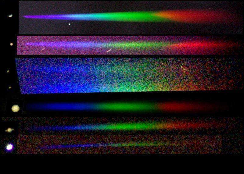

Nice! Here's one I put together of the planets (JPG):
I did this a long time ago, before I had a tracking mount- I can now leave the shutter open longer, getting a better signal-to-noise ratio. In any case, plotting the (B, G, R) values shows the color differences. Here's Venus (the top planet):
Note the pixel position of the red and green peak. For comparison, here's Mars (the next one down), which is redder in hue:
It's noiser, the peaks have shifted to larger pixel values and the red channel is generally brighter, reflecting the redder hue. Here's Jupiter and Saturn:
And the bottom one is a star, Porrima, bright and conveniently located:
The two dim ones are moons of Jupiter, which I can definitely capture next time.

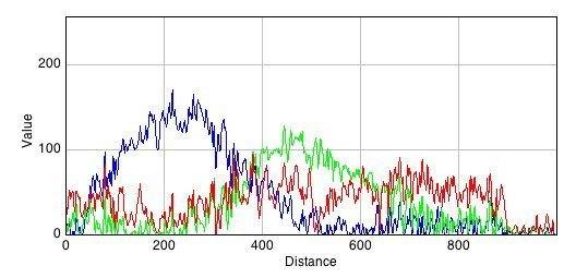

I decided that the flexibility of the cardboard box was one major problem.
I placed the lamp inside the box each time, and I'm sure it shifted the slit in the end, thus throwing off measurements.
On my 4th data collection run, my red LED finally burned out.
So for my 5th data collection run, I decided simply to take some photos of the light reflected by my LEDs, and see if I couldn't extract useful information from the RGB levels.
The data there was also screwy. I used my red laser pointer as a reference, and my camera thinks there is blue light coming out of it.
Code:
R    G    B     Notes
203  0    46    red laser
196  0    51    red laser
183  0    25    red led
165  0    9     red led
I believe it was at that point, that I decided that I should start over from scratch.
And perhaps get a new camera, as this one is obviously just making things up. o0)

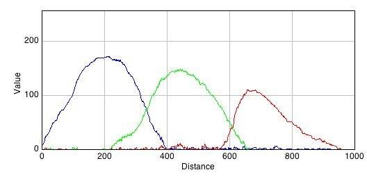

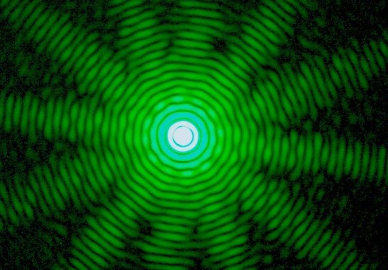

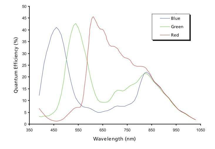

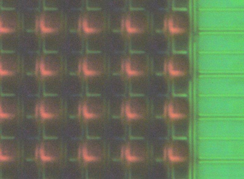

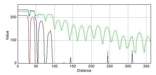

I see this issue as well, when I illuminate with a strong monochromatic source. I think it's a combination of Bayer filter artifact and intensity, but I don't know for sure. Here's an example, a diffraction pattern from a 532 laser:
And the color line trace from the central peak outwards:
The red and blue channels get excited when the intensity is high.
Likes OmCheeto and e.bar.goum

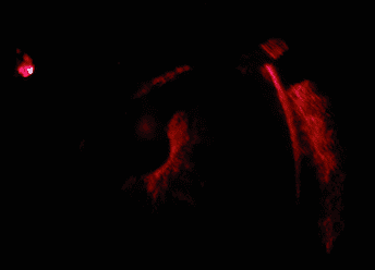

Here's a thumbnail of my red laser reflected off of a white surface.
I knew it would oversaturate my camera, so I duct taped my burned out led to the end to scatter the light.
Even the dimmest regions show blue.

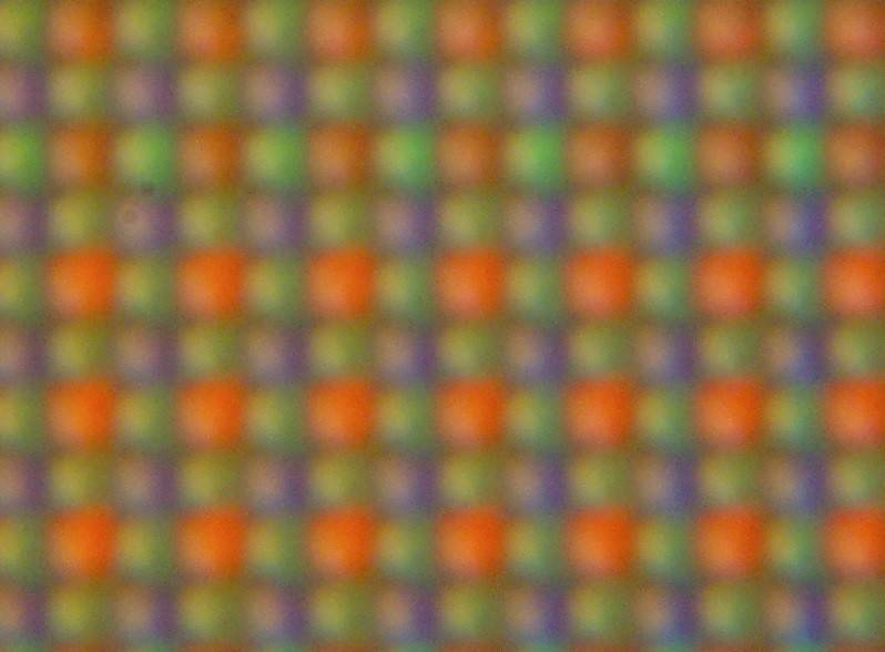

I too have seen this occur. It happens with CCD detectors where each pixel is essentially a potential well with a finite density of states. If the incident light intensity is high, the individual colour pixels saturate and charge starts spilling over into adjacent pixels. It’s called white-out and reducing the intensity should resolve it.
Even in the absence of saturation, a monochromatic input will still lead to some signal in all three colour channels because the red, green and blue pixel filters aren’t perfect. Here’s a plot of quantum-efficiency taken from the data sheet of a common CCD image sensor. Note that none of the filters completely block wavelengths outside of its pass-band.
I guess this might explain OmCheeto’s observation. Also, the signal processing in consumer cameras usually includes white-balance correction which adjusts the R-G-B signals to try to compensate for different lighting conditions. So interpreting those values to determine wavelength should be done with great caution.
Coming back to the original post about LED colour, I’ve noticed (through error, rather than design) that if I overdrive an LED the emission blue-shifts and broadens. I once accidentally connected an LED display directly to the supply without a current-limiting resistor. The normally red display lit up brightly with an almost whitish-orange hue. Then started to smoke! Maybe that’s why the OP observed orange emission from a red LED?

The more I think about Bayer filters, the more confused I get. First, they are thin-film reflective type filters as opposed to absorptive filters, because absorptive filters would degrade over time, leading to inconsistent and nonuniform bandpass changes. On the other hand, thin film filters only work over a restricted range of incident angle, so high-angle rays associated either with fast lenses or wide angle lenses would not be correctly filtered. I have never noticed such a thing, and have not heard anyone else noticing that.
But they have to be reflective- here's an image of light reflecting off the filter, then reflected again by the lens and captured by the sensor:
This is clearly a reflection, but... if this was light initially rejected by the filter, then the colors should be inverted: blue reflects yellow, green reflects magenta, and red reflects cyan. Although maybe the colors are inverted- I can't tell because I'm color blind :(
Imaging the filter directly is a challenge, this is the best one I've been able to make (so far):
This image was taken using brightfield reflection microscopy, but the light must be reflecting off the underlying pixels, not the filter, because the colors are correctly rendered. I don't understand the 'half pixel' appearance... I guess mine is broken as well :)
This is a pretty common Bayer pattern.
Notice that there are as many green pixels as there are red and blue pixels combined (or another way of putting it, twice as many green as red, twice as many green as blue). That's because the human eye perceives more detail in the green part of the spectrum. In the post-processed image luminance favors the green channel. By favoring green in pixel count, the silly human will perceive a more detailed image.
  • #33
Maybe the filter material (of a given pixel) reflects and transmits the same color, thus absorbing the other colors (neither reflecting nor transmitting the other colors*)? 'Like stained glass.
*meaning the other colors are not reflected, but they don't make it to the pixel element either.
