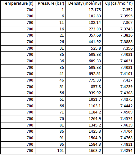

Hello, i am given an isothermal transition for nitrogen, N2, where temperature is constant at 700K, p1=1bar, and p2=100bar.
For this problem i am not allowed to use any equations of states, such as Benedict-Webb-Rubin, or Beattie-Bridgeman. Rather i am given only Cp data, which is in the table below. From only this data below for nitrogen i must determine the Enthalpy, Entropy, and Chemical Potential for the transition phase.
I am also given the equation below, which I am not too sure how to apply it to the problem.
R*T (a + b v^-1 + c v^-2 + d v^-3)
Start with definitions of the ΔH, ΔS and ΔG.
What are dh, ds, and dg in terms of dT and dP?
##\Delta G## is easy, but I still haven't figured out how to get ##\Delta H## and ##\Delta S##. Are you sure this is the only information they give you? Do they provide any information at any other temperature?
I'm guessing that the expression appearing above the table is the functional form they are recommending for the pressure. This is the equation of state. Am I correct?
