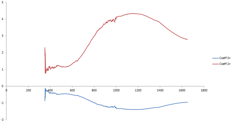

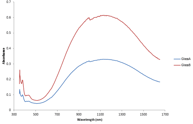

I attached the spectra of the two glasses I am using. Also, I have plot quickly (read as "I haven't add units and axis names") the absorption coefficients I obtained for Fe2+ and Fe3+. You see that εFe3+ is negative, which doesn't have any physical meaning.
Below you find the concentration data for both GlassA and GlassB.
GlassA:
CFe2+ = 0.056 wt%
CFe3+ = 0.125 wt%
CFetotal = 0.181 wt%
GlassB:
CFe2+ = 0.127 wt%
CFe3+ = 0.285 wt%
CFetotal = 0.412 wt%
If I substitute in GlassA CFe3+ = CFetotal - CFe2+, I get the same value: 0.181 - 0.056 = 0.125 wt%.
I would appreciate if you could keep helping me.
Thank you.

Nobody has an idea on what's wrong?
For the attached spectra, what value of extinction coefficient did you use for Fe+2 and Fe+3? Did you hold the extinction coefficient for Fe+2 constant? Or did it vary with wavelength?
they both vary with wavelength. In the 2-equations system I have attached to my first thread, the unknowns are the two extinction coefficients.
So you have the spectra in the form of wavelength and absorbance? Can't help you without raw data.
Yes, my data are absorbance as a function of wavelength. NOw I don't have access to the hard drive where data data are. I will post the raw data later on today so you can have a look.
thank you again!
sorry for the delay. here is the file with the absorbance for both glasses.
