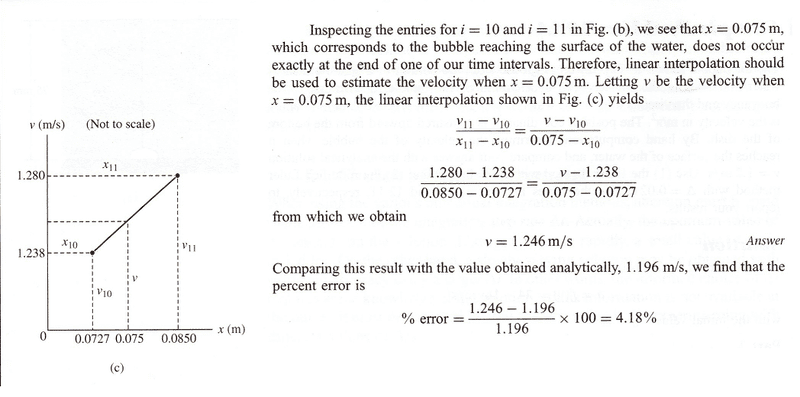

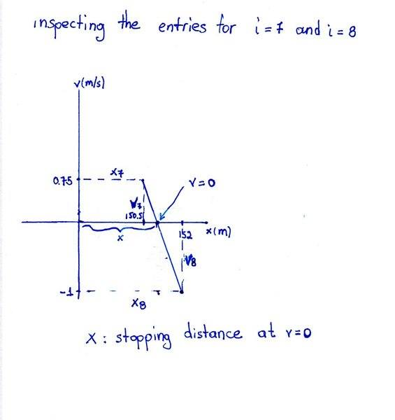

Is the stopping distance between x7 and x8 where the velocity is 0?
Do I use linear interpolation to find the stopping distance?
for example:
Do I use something like this?
If yes how do I apply linear interpolation in above graph to find x?
You could do that, but as you see there is little gain in accuracy (*)
You would use something like $${x-150\over v_7} = {x-152\over v_8} \Rightarrow x = \left ( {150.5\over v_7}-{152\over v_8} \right )/ \left ({1\over v_7}-{1\over v
_8}\right ) $$ or 151.14.
(*) the error the Euler integration makes in the first step is already about 3.5 m
( ## x = v_0 t -{1\over 2} a_0 t^2 \ ## gives 36.5 m instead of 40 m, the exact formula ##v_0 t - {1\over 2} {7\over 4} t^2 + {1\over 2}{1\over 3} {\displaystyle t^3\over 16} ## gives 36.6 m )
