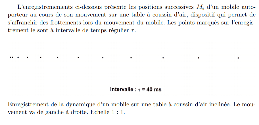

I'm struggling to start this exercice, where I have an inclined air hockey table with an angle alpha.

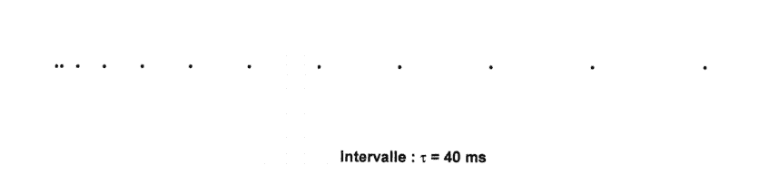

They gave me this chronophotography (this is online) saying that the ratio is 1:1
I really don't know how to proceed since this is online and I'm thinking if I measure this with a ruler, the ration may not be adapted anymore (right?)
I'm tried to calculate the instantaneous speed then deriving it to get to the accelaration but I don't have the speed function so that didnt really work out. Excuse me if I have misused any vocabulary, I translated this from French.
Thank you so much for your help!
So an inclined air hockey table is just an approximation for a frictionless inclined plane or ramp. Yes, use a ruler to determine each displacement from the left starting point, and make a chart of those measurements versus the ##\delta t## time ticks. Do you know the length of the time ticks, or are you just supposed to keep that as a variable?
You then just calculate the velocity and acceleration based on the deltas. You can make another two columns in your table where you calculate the velocity as the change in position for each time tick, and then use the velocity v(t) column to likewise calculate the acceleration numbers. Does that help? (Excel is a good tool to use for making this table...)

Yes, it's equal to 40 ms

I'll try with excel but, if I zoom on the image, will it falsify the ratio? And for a 1:1 ratio, does it mean that if I measure 1cm on the pc screen, I'll use that measurement directly for my calculations?

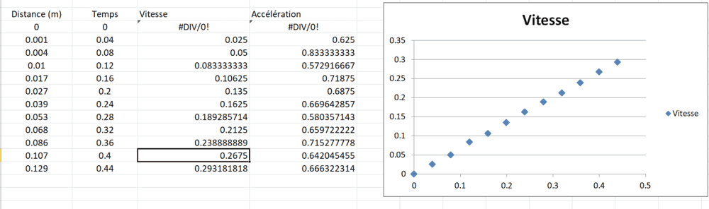

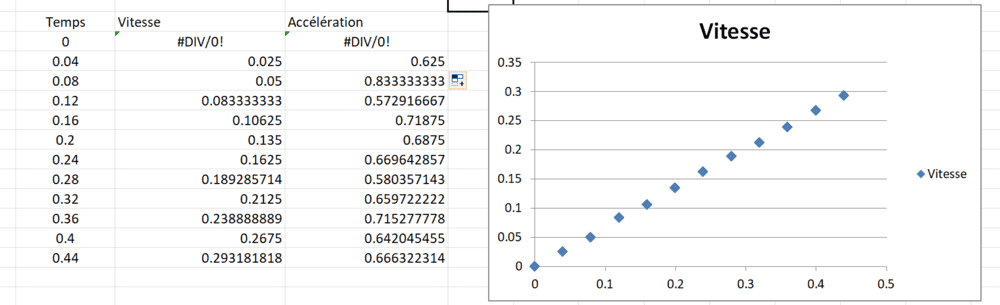

I managed to get this graph, and I tried to set Acceleration = Speed(n+1) - Speed n / Time (n+1) - Time (n)
Does this mean that the accelaration is equal to 0.625 m/s^2?
Thank you!
Looks like you are getting close, but where is your position data? Or are the column labels shifted left somehow? The 4 columns should be Time, Position, Velocity, Acceleration. And the position at t=0 should be x=0.
Yes sorry it was shifted to the left. But I tried to use the value of the slope to determine the acceleration but it was incorrect. And if speed is a straight line, it means that the acceleration is constant no?

So the initial velocity is equal to 0, and by that you're saying that a = 2 times the value of the slope.
But by doing the excel, I ended up with many slope values.
And when I tried enter the value of a = 0.625 x 2 = 1.25 it was the wrong value.
Do I have to calculate the average of all the slope values? Since these are measurements with a ruler on a pc screen, i don't know how I would be able to get to a precise value..

Excel will give you only one slope if you ask it to "Add a trendline" and select a linear fit. If you don't know how to do that, ask Excel Help.
Do you know the correct answer? I am asking because your distances may need to be rescaled. If you used a centimeter ruler to measure distances on your screen, you will get different values if your "screen" is a desktop, laptop, notebook tablet, cellphone, etc. Whoever wrote this problem should have provided a length next to the dots saying how long it is whatever units. The 1:1 ratio is meaningless.

No i do not know the correct answer. This is a picture of the exercice.
It's just indicated 1:1 ratio. I have zero idea about what is the equivalence of the distance I measured with a ruler. So I just decided to use the distance I measured with a ruler to put in the excel.

@duchuy what is the standard width of paper in your country? In the US it is 8.5" wide. So if the problem looks like it could be printed on standard paper, that is probably the scale 1:1 they are referring to. If you do a Print Preview on the problem, you could scale your measurements with respect to what you measure for the width of the paper. That's the only thing I can think of, short of asking your TA/professor for clarification.

What you have calculated for velocity (speed) at time, ##t##, is ##\dfrac{x(t)-x(0)}{t-0} ##. This is the average velocity over the time interval from 0 to ##t##. If the acceleration is constant, then this velocity also corresponds to the instantaneous velocity at time, ##\dfrac{t}{2}##.
Alternatively: It appears from the data that initial velocity was very near zero. In this case, the instantaneous velocity at time ##t## is 2 times the average velocity over the time interval from 0 to ##t##. You can simply double each value in the velocity column.
As for the acceleration values you obtained: In post #6 you wrote,
duchuy said:
I managed to get this graph, and I tried to set Acceleration = Speed(n+1) - Speed(n) / Time (n+1) - Time (n)
First of all, I think you mean, Acceleration(n) = (Speed(n+1) - Speed(n)) / (Time (n+1) - Time (n)) .
The extra pairs of parentheses are important.
Using the corrected velocity values, which are twice the values you have in the table, will give acceleration values which are likewise twice the values you have in your table.
But I was curious about how you list an acceleration value for the ##t=0.44##s, as that would require using velocity and time values from the line below that line. It looks like the table and graph were generated using a spreadsheet, so I guess the spread sheet used zeros for those values. Indeed, ##\dfrac{0-0.2931818...}{0-0.44)} = 0.66632...\ ## .
