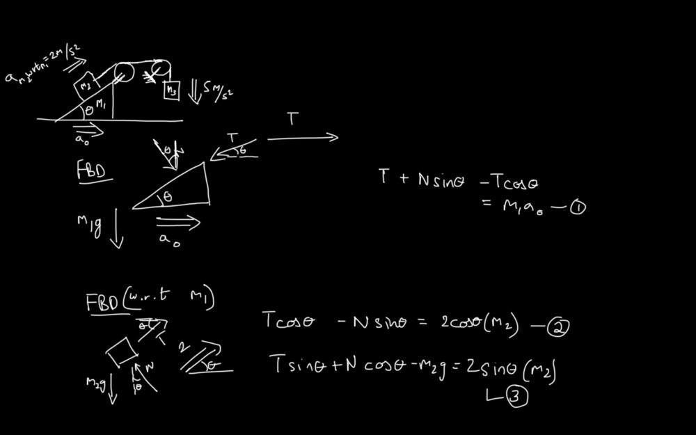

The acceleration of block m2 with respect to m1 is 2m/s^2 upward along the inclination. The block m3 accelerates downward with 5 m/s^2.
a( of m2 wrt m1) = 2m/s2
a(of m3) = 5m/s2

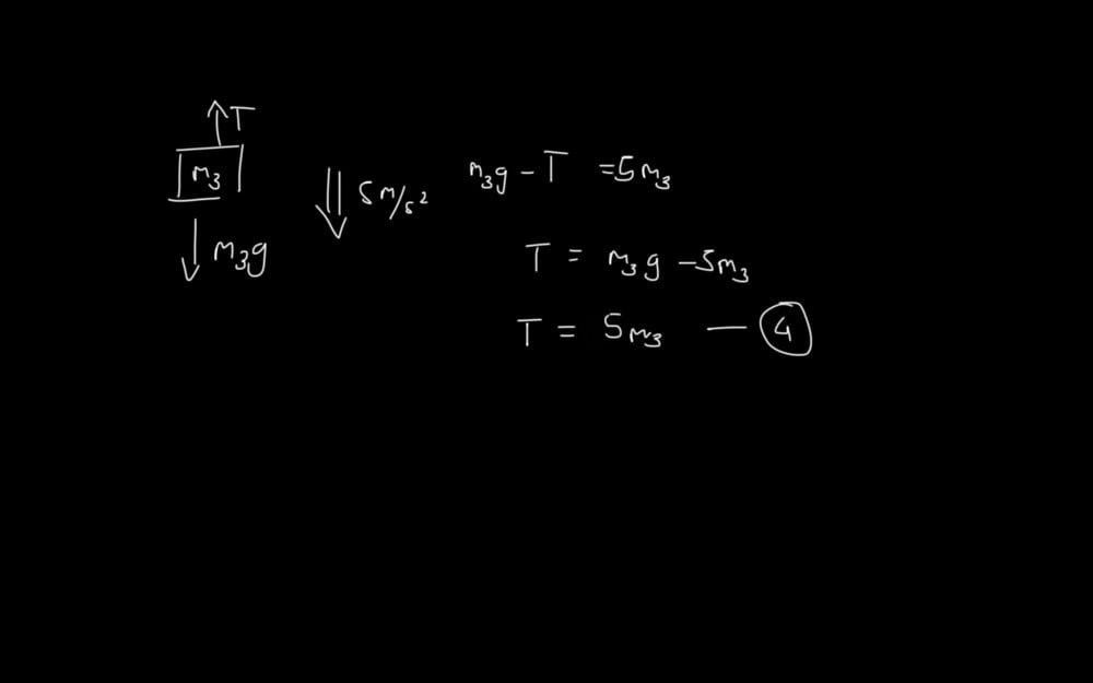

The equations i got are attached below. Is it right? If yes what should we do after this. I tried solving the equations, but i did not arrive at the solution.

What quantity are you trying to determine? If it is ##a_0## (the rightward acceleration of block ##m_1##) then you seem to be overthinking it.
Likes Kaushik
Yes. I am trying to determine ##a_0##. So, do we have an easy way to solve this problem?
Yes.
Let us start with a simpler version of the problem. If blocks ##m_1## and ##m_2## were glued together, how rapidly would the pair need to be accelerating rightward so that ##m_3## would be accelerating downward at 5 m/sec2?
Likes Kaushik
jbriggs444 said:
Yes.
## 5 \frac{m}{s^2} ##?
Yes indeed.
If block ##m_1## were glued to the ground while block ##m_2## were once again free to slide, how rapidly would it need to be accelerating so that block ##m_3## would be accelerating downward at 5 m/sec2?
jbriggs444 said:
Yes indeed.
## 5 \frac{m}{s^2} ##again? as the pulley attached to ## m_1 ## is not moving anymore?
Yes. Now unglue all blocks and return to the original problem. Can you write an equation for the downward acceleration of ##m_3## in terms of the rightward acceleration of ##m_1## and the diagonal acceleration of ##m_2##?
[If it were me, I would label the accelerations of ##m_1##, ##m_2## and ##m_3## as ##a_1##, ##a_2## and ##a_3##]
Likes Kaushik
Is ## a_0 = 3 \frac{m}{s^2}##?
Likes jbriggs444
Yes
Likes Kaushik
jbriggs444 said:
Yes
Oh, thanks. But in my book the solution given was 2. So is the solution given in my book wrong?
Yes, assuming the question is as stated then the book is wrong.
Likes Kaushik
jbriggs444 said:
Yes
I used relative acceleration.
If the block ## m_3 ## is accelerating downwards with 5, then string that is horizontal should also accelerate right with 5. But the acceleration of that horizontal string with respect to the block ## m_1 ## should be 2.
Let the horizontal string be h.
## a_h = 5 \frac{m}{s^2} ##
## a_{h} ## ( with respect to ## m_1 ## ) ##= 5 - a_0##
But as ## a_h ##(with respect to ## m_1 ## ) ## = 2 \frac{m}{s^2} ##
we get ## a_0 = 3 \frac{m}{s^2} ##
