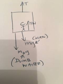

I drew a diagram , I’m no sure I am correct because I keep getting a number greater
Draw a free body diagram, then apply the relevant equation that you posted.

Would this be all the forces ? Or would the dumb waiter exert a normal force as well
You have ΣF=ma equation for the man. Your second one can be either for the dumb waiter only or for the man+dumb waiter combination. Your choice.
If for the dumb waiter, what force does the man exert on it? Remember Newton's laws.
If for the combination, ignore forces between the man and the dumb waiter since they are internal to the system, but be careful about the force the rope exerts on the combination.

If I were to chose only the dumb waiter c wouldn’t it be the gravitational force going down and the tension ?
So it’ll be
Fnet=ma
T-Md=Md(a)

You left out g, and another force. As I wrote, remember Newton's laws.

Oh yes !
Wouldn’t it be the man’s force being exerted down on the elevator ?
T- Md•g - M•g = a(Md+M)

In Fnet = ma, m is the mass of the system. Your system is the dumbwaiter, so what quantity should multiply a?
Also on the left side you have M⋅g. That's the force that the Earth exerts on the man, however neither the Earth nor the man are part of this system. The force exerted by the man on the dumbwaiter is not his weight. What is that force? As @haruspex wrote, remember Newton's Laws.

So you would multiply a by 40? The mass of the dumbwaiter . So then the missing force would be the normal force in which the scale reads ?
T - Mdg + Fn = Mda ?
Since the man isn’t part of the system , his mass or weigh shouldn’t be included ?

Which way is the normal force acting on the dumb waiter?

Yes.
However, the man’s force being exerted down on the elevator isn't mg in this case.
What does Newton's third law say about the force the man exerts on the elevator as compared with the force the elevator exerts on the man?

It’s going up , so shouldn’t it be added to tension

That they should be equal but since the elevator is accelerating wouldn’t that make his weight seen heavier or lighter depending the speed it’s going ?

No. The weight is the force Mmang with which the Earth attracts the man. What changes is the normal force exerted by the scale on the man that always adapts itself to provide the observed acceleration. The scale measures the normal exerted on its surface. Just push down on a scale with your hand to convince yourself that it is not displaying your weight.

Oh, I see
So then it’ll be
T-209N-40g=40a ?

It'll be that.

The normal force between the man and the dumb waiter (we can ignore the scale since that is considered massless, so just transmits the force straight through) must be up on one and down on the other. Does it act down on the man and up on the dumb waiter or the other way around?

Wouldn’t it be the other way around ? Up on the man and down on the dumbwaiter ?
Up on the man and down on the elevator is correct. Your equation in post #22 is also correct. Where does your equation in post #24 come from?

My teacher explained to use two different equations when two variables are unknown, I was trying to find another equation to substitute T with

You have the correct information for the man in post #5.

Use 209 Newtons for Fn and mg for Fg, of course with 82 kg for the man's mass.
Then as @kuruman wrote, your equation in post #22 is correct.

Use those two equations to eliminate T (or eliminate a if you'd rather find the tension).

Right, but in post #16 you had an equation for the dumb waiter with T...+Fn = ...
If the tension is acting upwards on the dumb waiter and the normal force is acting downwards then they cannot both be positive on the same side of tne equation.
  • #34
I have a suggestion for OP, @y90x. Why don't you write two equations for Newton's 2nd Law, Fnet = ma, one for which the system is the man and one for which the system is the dumbwaiter and in which only symbols appear, not numbers, and post them. One (or more) of us will review these equations and point out what is wrong (if anything) with them. At this point, it seems to me there is some tail-chasing going on here so a fresh start would be beneficial.
