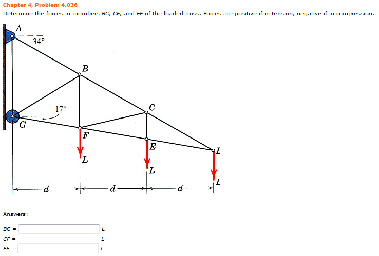

Determine the Forces in the Specified Members.
In summary, the problem is to determine the forces in members BC, CF, and EF of a loaded truss. The method of sections was used, resulting in a system with two L forces at E and D, as well as the forces of members BC, EF, and CD. The moment about point C was taken and an equation was formed, but the distance of CE could not be determined. Help is needed to find the distance of CE and solve the problem.
Northbysouth
249
Determine the forces in members BC, CF, and EF of the loaded truss. Forces are positive if in tension, negative if in compression.
I have included an image
ƩM = 0
ƩFy = 0
ƩFx = 0
I'm a little stuck on this one.
I tried using method of sections, whereby I drew a line through the middle of lines BC, CF and EF and then focused on everything to the right of that line. What this gave me is a system with two L forces, one at E and another at D as well as the forces of the members BC, EF and CD.
From here I tried to take the moment about point C,
ƩMC = 0
0 = -L(d) + EFcos(17)
however I ran into difficulty because I couldn't figure out what the distance of CE is.
Help would be appreciated
ƩMC = 0
0 = -L(d) + EFcos(17)(length of CE)
It's just a bit of trig and geometry to find the distance CE. The length 'd' is known and a couple of the angles...find the vertical legs of triangles with side d and angle theta...draw a sketch...otherwise, your equation is good when you add your omission noted in red
