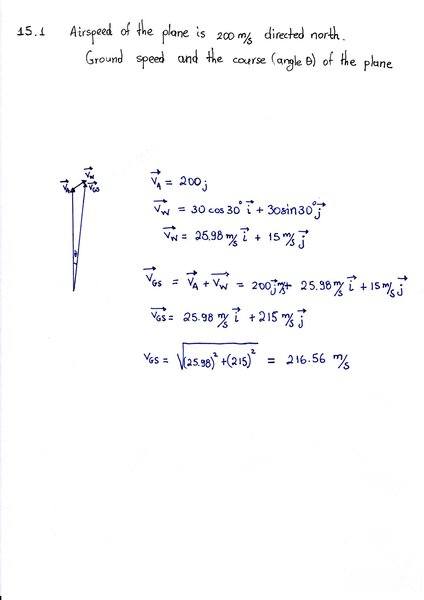

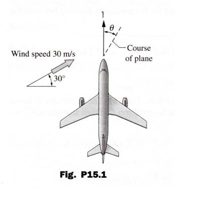

15.1 The airspeed of the plane is 200m/s, directed north. If the wind speed is 30m/s
in the direction shown, determine the ground speed and the course (angle θ) of the plane.
Is it so far correct the above?
More questions will follow regarding the vector diagram and understanding of theory

It seems correct, but you do not really need to compute the components. Just apply the cosine and sine theorems on the vector diagram.
