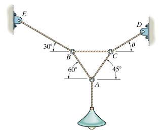

Each cord can sustain a maximum tension of 31 lb .
Determine the largest weight of the lamp that can be supported.
Determine θ of cord DC for equilibrium.

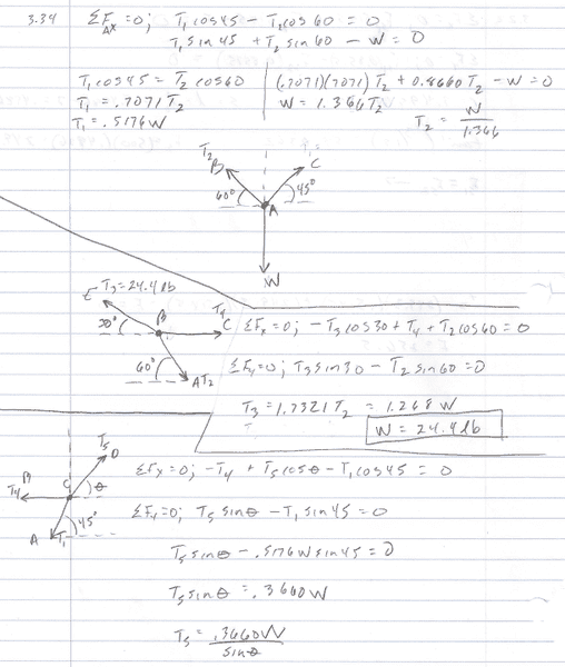

I found the answer to the first part of the problem (24.4lb) but not sure how to get theta.
How did you get the maximal weight without knowing the angle?
What did you try so far?
What is the first step?
Sorry for the hand written notes. The answer to the first part is boxed in in the middle of the page. I haven't really done anything other than stare at my equations for the second part. I assume I am working with the equations associated with the FBD at the bottom of the page. T(1)=12.63lb., T(2)=17.86lb, T(3)=30.93lb
As mfb posted, you cannot be sure of your answer to a) until you have found theta.
You can find T4 from analysis of B.
The CD connection could break as well. You cannot know when that happens without the angle.
