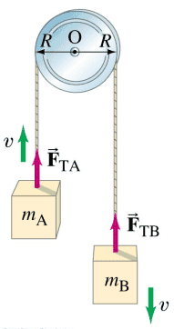

Two masses, mA = 40.0 kg and mB = 55.0 kg, are connected by a massless cord that passes
over a pulley that is free to rotate about a fixed axis. This device is known as an
Atwood’s Machine. The pulley is a solid cylinder of radius R = 0.360 m and mass of 7.50
kg.
1. Determine the linear acceleration of the two masses
2. Determine the angular acceleration of the pulley
a=atan+ar
not sure how to start, any hints would be great

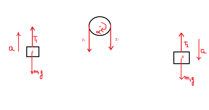

First draw free body diagrams of ##m_{a}##,##m_{B}## and pulley separately.
Try to make equations by using Newton's second law of motion and rotation.

I have made free body diagrams for you
Can you form equations using Newton's second law of motion and rotation.
Just use variables as shown in diagram. Do not put the numerical value right now.
so
fnet = total mass * acceleration
fnet = the sum of all forces on both objects
making it
total mass * linear acceleration = sum of all forces
linear acceleration = 9.8(-40+55+7.5)/(40+55+7.5)
linear acceleration = 2.15rad/s^2
The pulley does not fall not rise or fall, and its mass should not be added to the other two masses. And its weight plays no role...
The contribution of the pulley is to decelerate the masses absorbing a part of the variation of their PE in the form of rotational KE. That's why I pointed out that the problem could be solved 'by energies', equating the loss of PE of the system with the increase of linear KE plus rotational KE...
